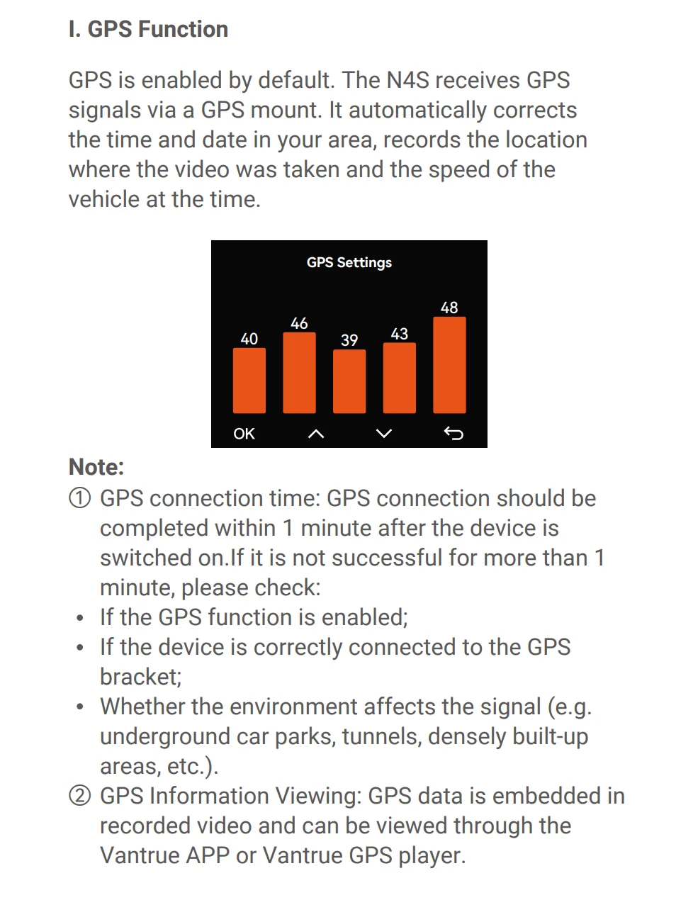

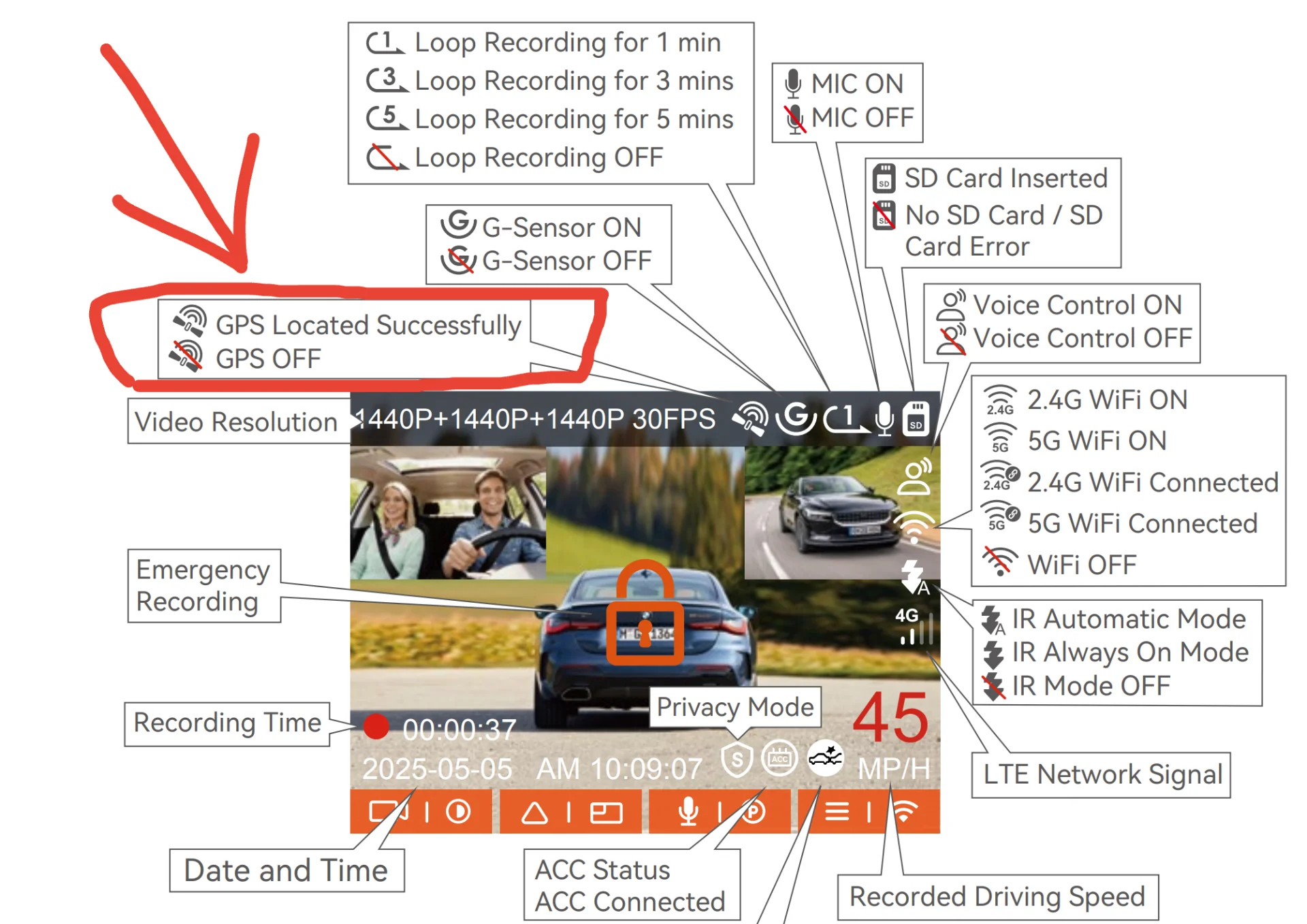

Check the settings in your camera for a GPS Signal Strength Display.
This might help you diagnose GPS signal reception issues.
See attached screenshots from the user manual.

Hey Chuck, thank you for the fast reply. I do park under a metal roof with the front and back open. So, that could very well be the case. I have about a 15 mile drive to work and it still didn’t show on the screen. I will check the gps strength when I get off. Thank you again. 😊
