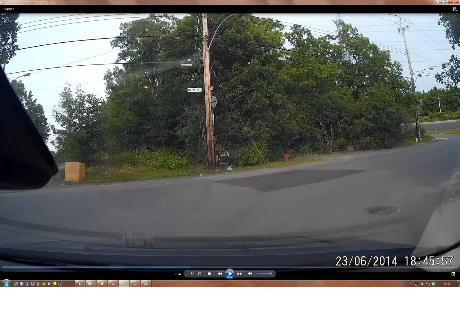

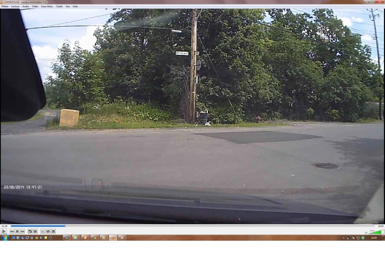

ok some news, i got my G1WH from foxoffer, this time it is the real deal,
there is a huge difference in quality, graphically but also the sound is much better, with the 96220 it was inaudible, but with the 96650, sound is very good
with the 96650, image is much crispier and it does record in .mov with 30 fps, also a 10 min video is about 1gb with the 96650, while it was 2gb for the same length with the 96220
96220
96650
The quality of the 96220 you posted looks like from a G1W knockoff o.o
that's exactly what it is, a cheap copy, and the reason why i got refunded

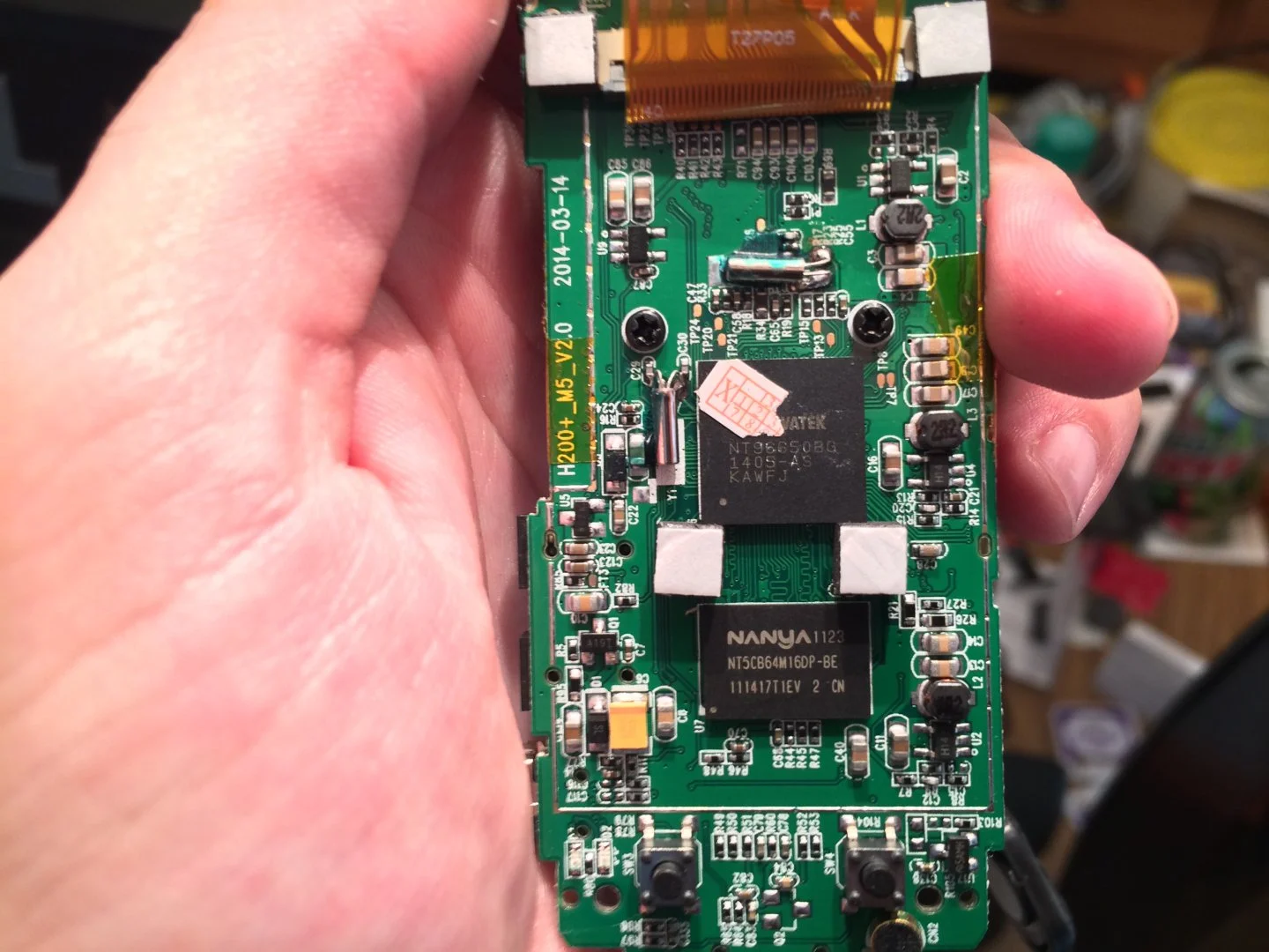

so is there anyway to find out if yours is fake besides opening it up for sure? ive opened it up but havent taken the mother board out. mine came in the orange box, has HDMI, and the files are 1080p .MOV files.
well i scared myself for a second thinking I had a fake, especially when i finally got it open and the damn thing had a sticker COVERING the processor. thought they did that on purpose to hide that it was a fake.

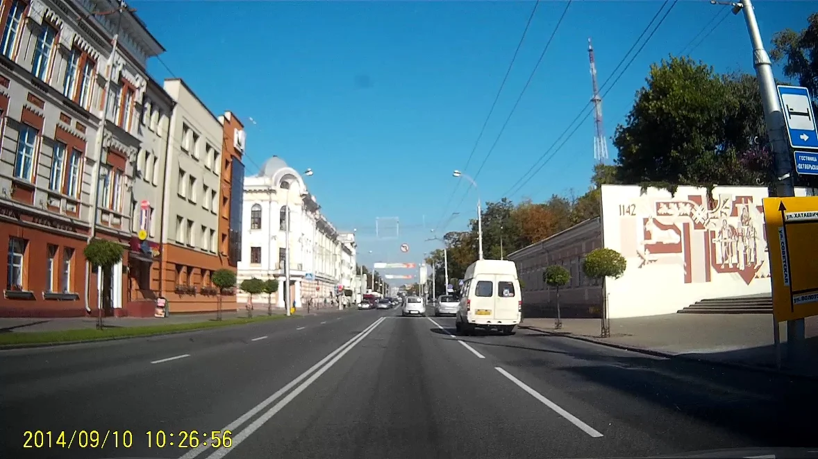

guys, please, maybe anybode knows, what is wring with my G1W (the dashcam is the original one, as I opened the body to check the name of processor - 96550)? It seems like out of focus. Please, see the files attached. Thank you very much!
It looks like the lens may be slightly out of focus. You can refocus the lens manually and then secure the threads again with a spot of glue or use tape if you want to be able to readjust the focus again in the future. You obviously already know how to open the housing of the camera.
