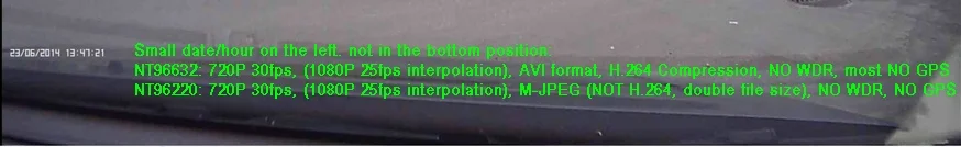

I think the first way to identify the chipset is looking at date/hour.
Dashcam with Novatek NT96650 chipset:
Dashcam with Novatek NT96620 chipset:

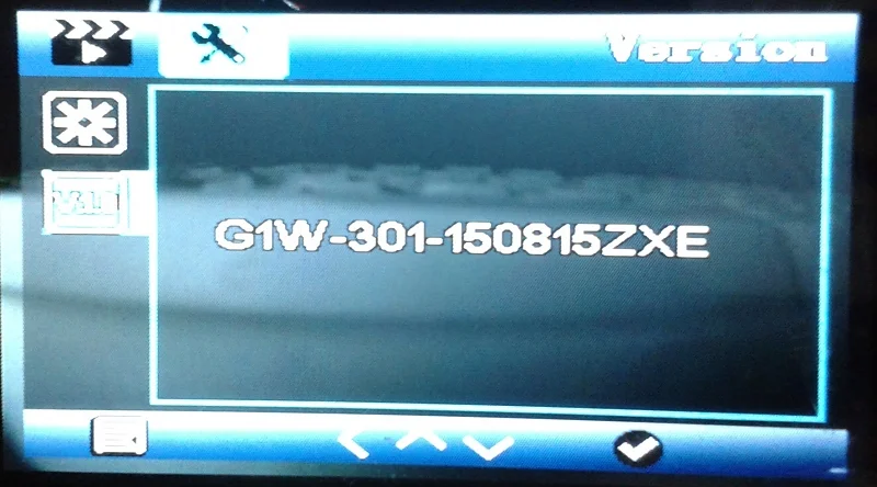

I have one blue bought in E-prance on Aliexpress. I simply took a photo and right click on file, it shows a name of chip:
camera model: 96650
It still has 30fps and .mov format video, so blue color is a real G1W. The box is orange.

Perhaps someone could create a stickied thread 'How to tell if your G1W is fake' or something similar. The pictures / screenshots that KCO and Mtz took are especially useful and quick way to identify different versions.

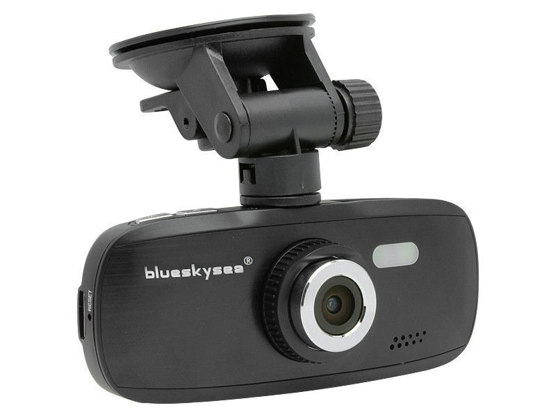

Yes,in order to do something in a simple way,we starts to label our company logo "blueskysea" on cameras;
So,you can contact us more simple if you find there is one"blueskysea" logo on camera!

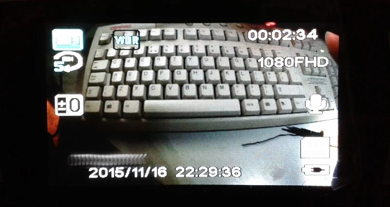

I think I have a fake orange box also... I am suppose to have chipset NT96650 and my screen is so bright its like it pointed into the sun. It states on the box MOV files... They are AVI files... My date and time are also different, number are white but the area in which they are is a black box on the lower right hand side. My other BlueSeaSky where just numbers on the screen and not in a blacked out box.

Latest model or another Fake?

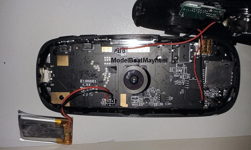

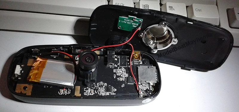

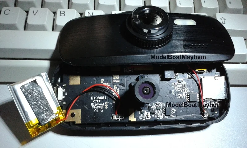

This is what the inside of myG1W (ebay) looks like.... no CPU at all!
.... well hopefully there is one on the LCD side?!?!?

That's strange.
One can usually tell the chip from the timestamp though, do you have a screenshot?
