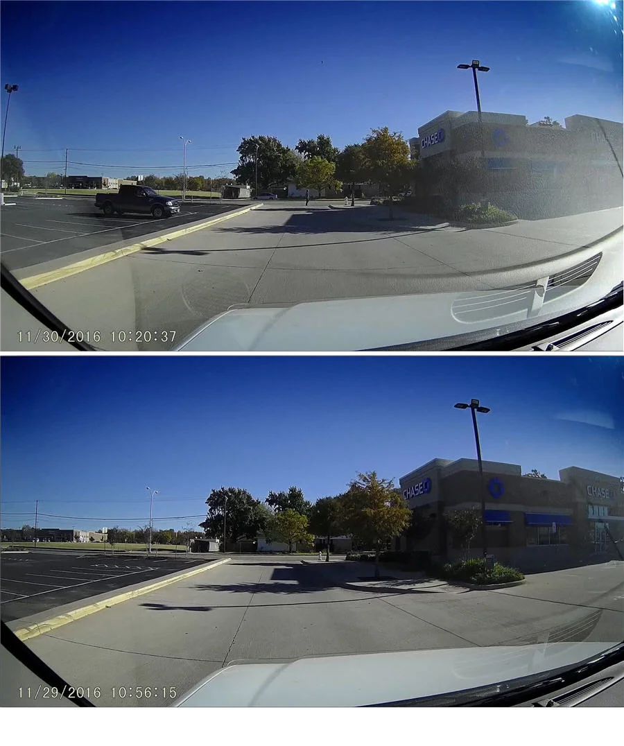

Another comparison without and with the CPL filter...
You need to eliminate the cause of the reflections instead of the reflections. The reflections of the dashboard are still there, even with the filter.
Two examples of the dashmat's effectiveness:
Problems with a mat are covering the top dash speakers, the ambient light sensor for the automatic headlights, and the defrost vents you see in the reflections. I might have been able to reduce the reflections further had I fine-tuned the filter rotation. Anyway it's not 100% but still very effective depending on the angle of the sun.
Well, whatever the update did, it did not help the white "red and green" light symptom.
