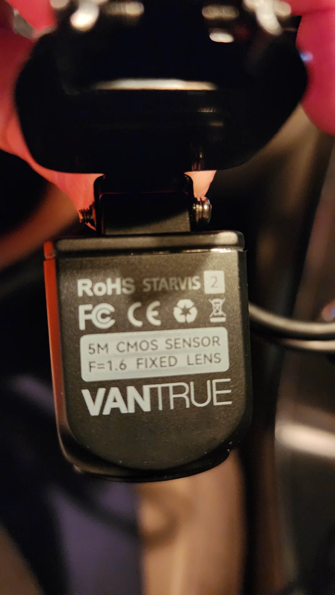

@EricSan @Hack_man @jsmith I just confirmed with our team. During the trial production stage, some early units were mistakenly stamped with F1.6, but the actual aperture is F1.8, as correctly stated in the manual. Sorry for the confusion.
So it seems then that @EricSan @Hack_man and I did get the early trial production models with the 1.6 versus 1.8 Stamp. Are these early stage models retail versions or pre-production?
@EricSan @Hack_man

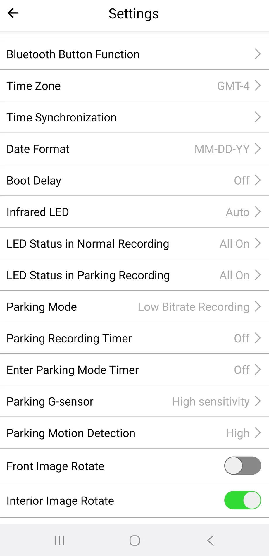

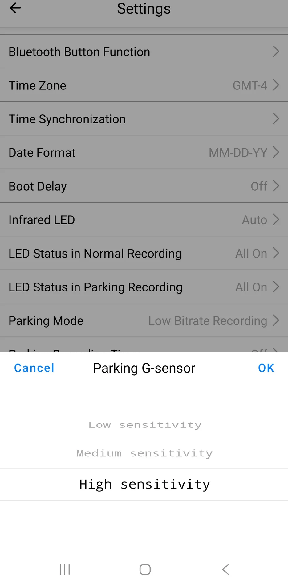

I'm not sure what you mean "G Sensor triggering is automatic". I agree the Default is 3 for all cams but there is an option to turn G sensor triggering completely OFF for Driving mode. I have changed my setting for all three directions to "2" so that I can test if it's ultra sensitive.
For Parking Mode, there are options for 1 2 3 4 5 Sensitivities in Collision Mode so I'm not sure what it means to say the setting is "Universal during parking mode" or that there is no option for G sensor customization.

While you are correct Collision offers this feature, I think Viofo handles differently. Notice separate parking G-Sensor Option.
Whoops! I never noticed "OFF" function on any G-Sensor. Viofo and Vantrue both have that capability. Learn something new and be more observant on my part!

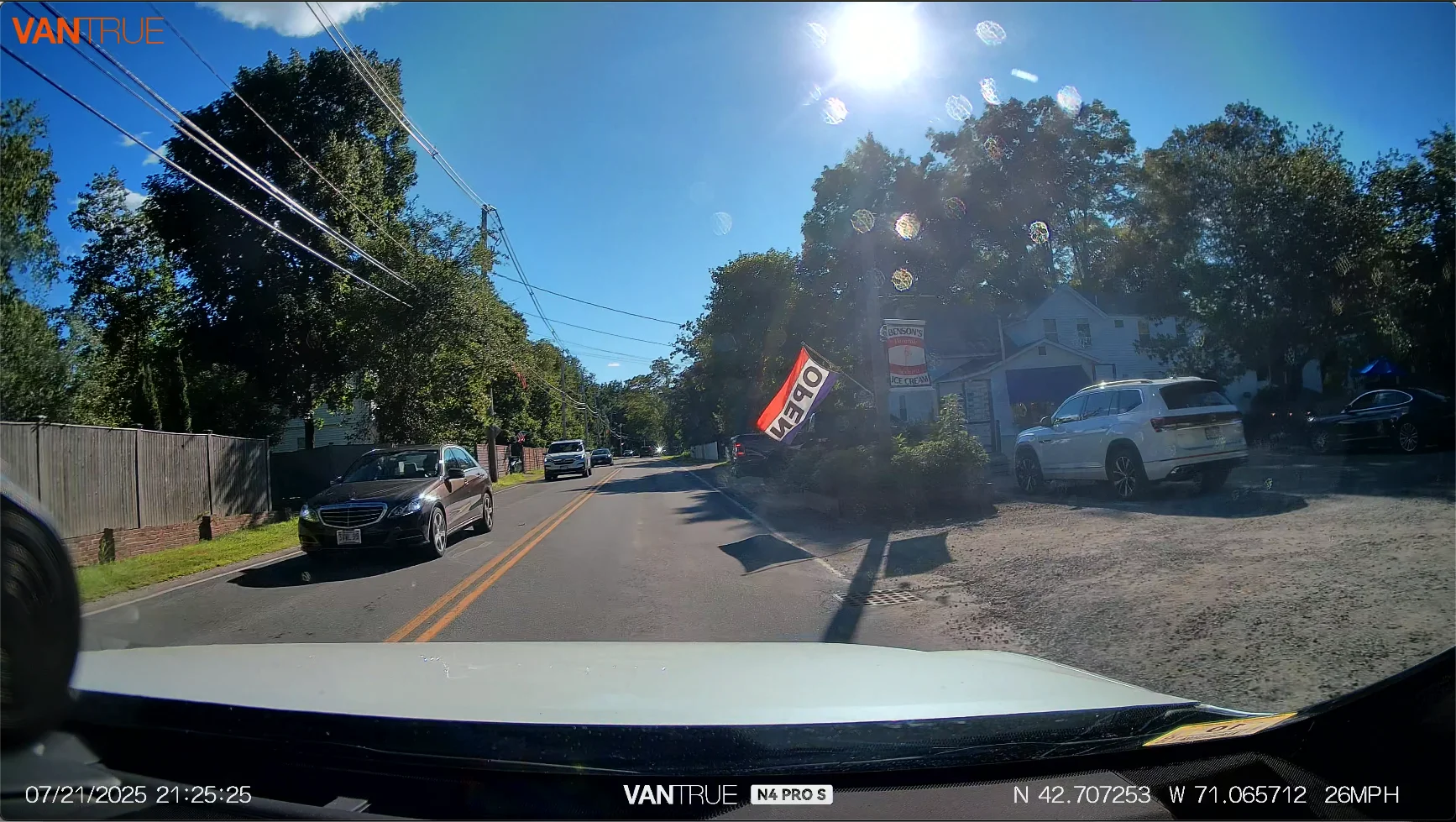

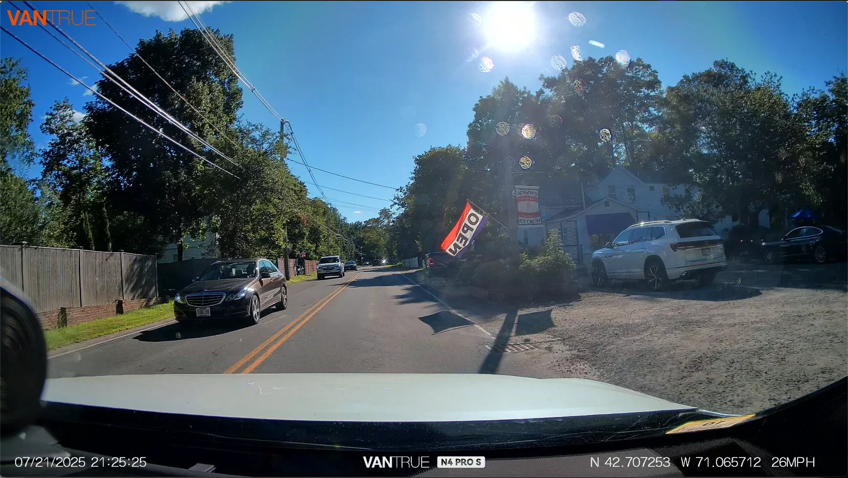

I'm presenting comparison footage looking towards the sun with A229 Pro and N4 Pro S (both 4K front cameras)
The detail looks very similar. The Vantrue shows a deeper blue sky which has been a common theme when comparing with Viofo.
I believe the white circular dots are some tree sap I picked up JUST AFTER meticulously cleaning my windshield 🙁
I'm going to try to pass thru that area again at the same time with PlatePix turned ON.
N4 Pro S - CPL filter Installed, HDR and PlatePix OFF
A229 Pro - CPL filter installed, HDR OFF
N4 Pro S - CPL filter Installed, HDR and PlatePix OFFView attachment 82931
Seems text is a bit more legible on the Viofo A229 but that could also be placement of camera, too.
I was slightly leaning towards that conclusion but it's close, it's hard to call.
It is possible that the A229 Pro has a higher bitrate than the N4 Pro S which may help to maintain more recorded detail. Although I understand the N4 Pro S records in H265 so a direct bitrate comparison does not tell the whole story.

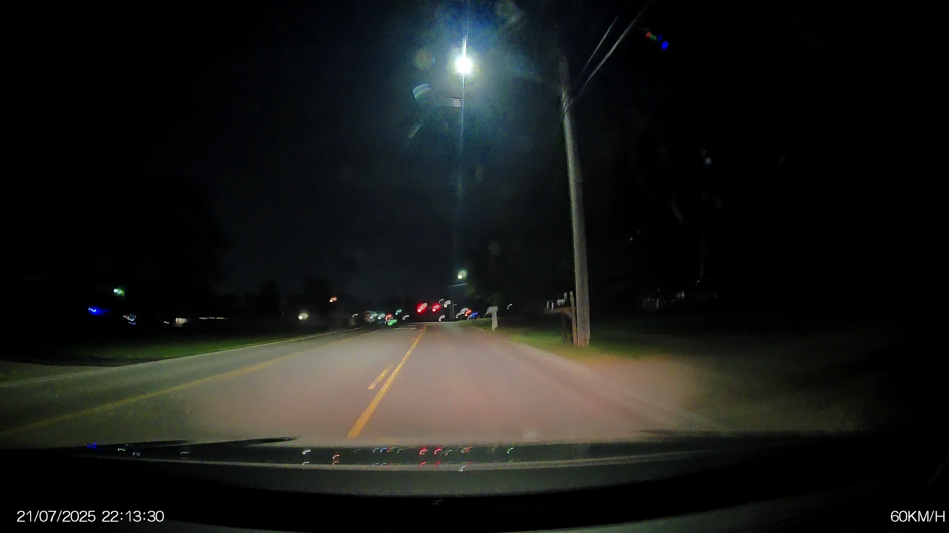

When driving with HD (Need to test without to see if same issue), no CPL,the picture is quite bright but also does have motion blur. Do you notice when hitting a bump at night with HDR enabled, the image gets blurry for a second? I wonder if this is HDR processing taking place (trying to capture multiple stills of images), and the vibration disrupts its algorithm.
Again, I'm not sure if this happens with HDR disabled. I'll need to test that one.
