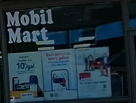

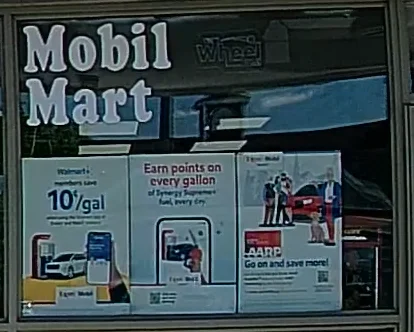

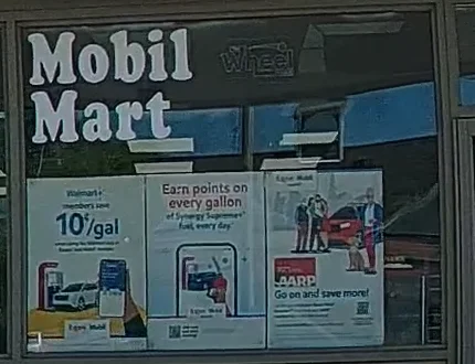

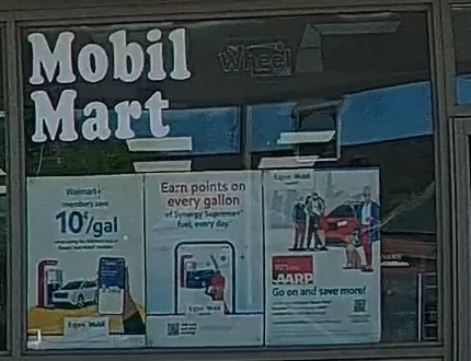

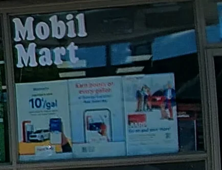

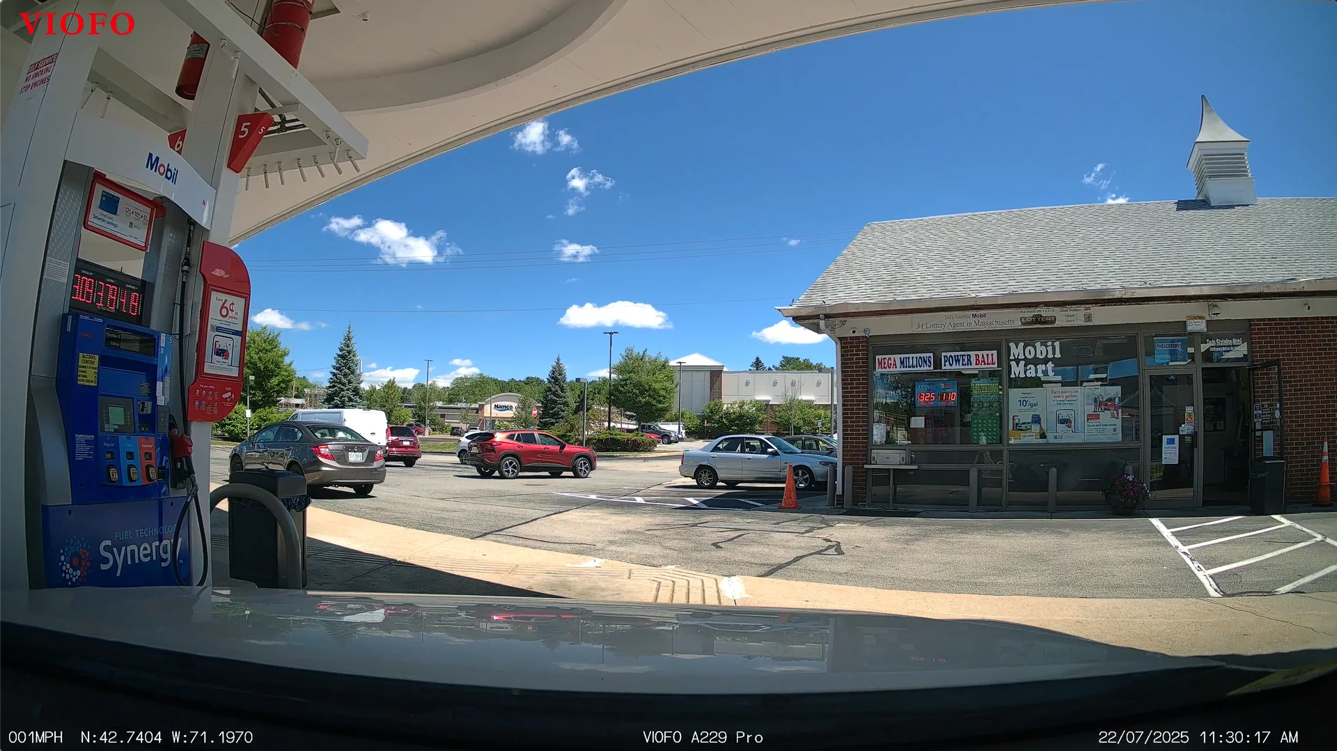

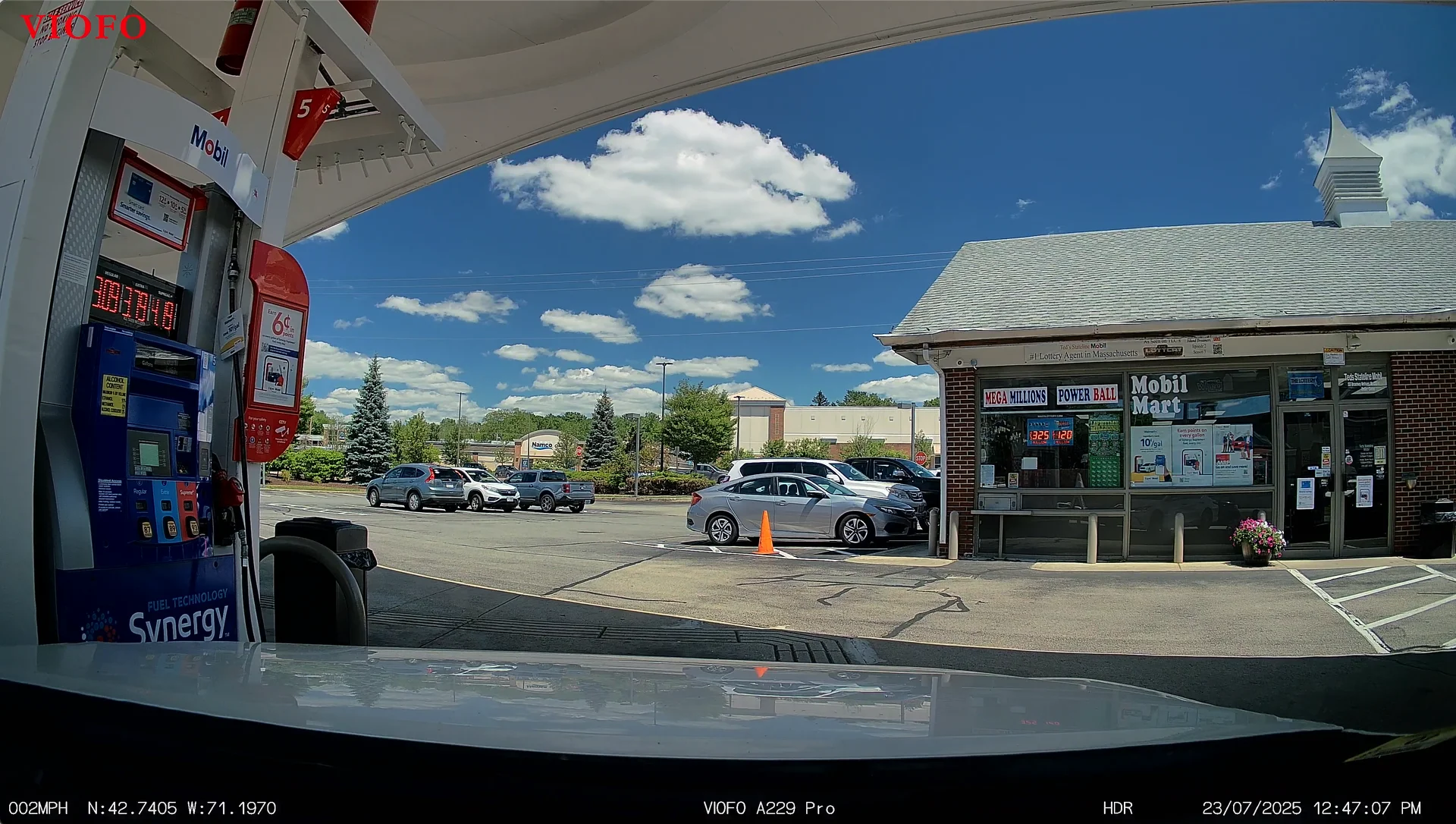

Comparing A229 Pro with N4 Pro S
In this normal lighting environment the signs on the storefront are more legible with the A229 Pro but as @TonyM pointed out this could be due to the higher bit rate of A229 Pro (37.7 Bit/S) vs N4 Pro S (31.95 Mb/S)
See enlargements below
N4 Pro S - HDR ON PlatePix ON

A229 Pro - HDR OFF
A229 Pro - HDR ON
N4 Pro S HDR ON PlatePix ON
N4 Pro S HDR OFF PlatePix OFF

A229 Pro HDR OFF
A229 Pro HDR ON

I turned on HDR for the VIOFO and added it to Post #9.
I am repeating the enlargements below for convenience.
I also added a shot with N4 Pro S - HDR OFF and PlatePix OFF
The middle sign "Earn points on every gallon" shows the most difference, with N4 Pro S struggling a bit both with and without PlatePix, The A229 Pro with HDR ON and OFF are both fairly legible.

A229 Pro - HDR OFF
A229 Pro HDR ON

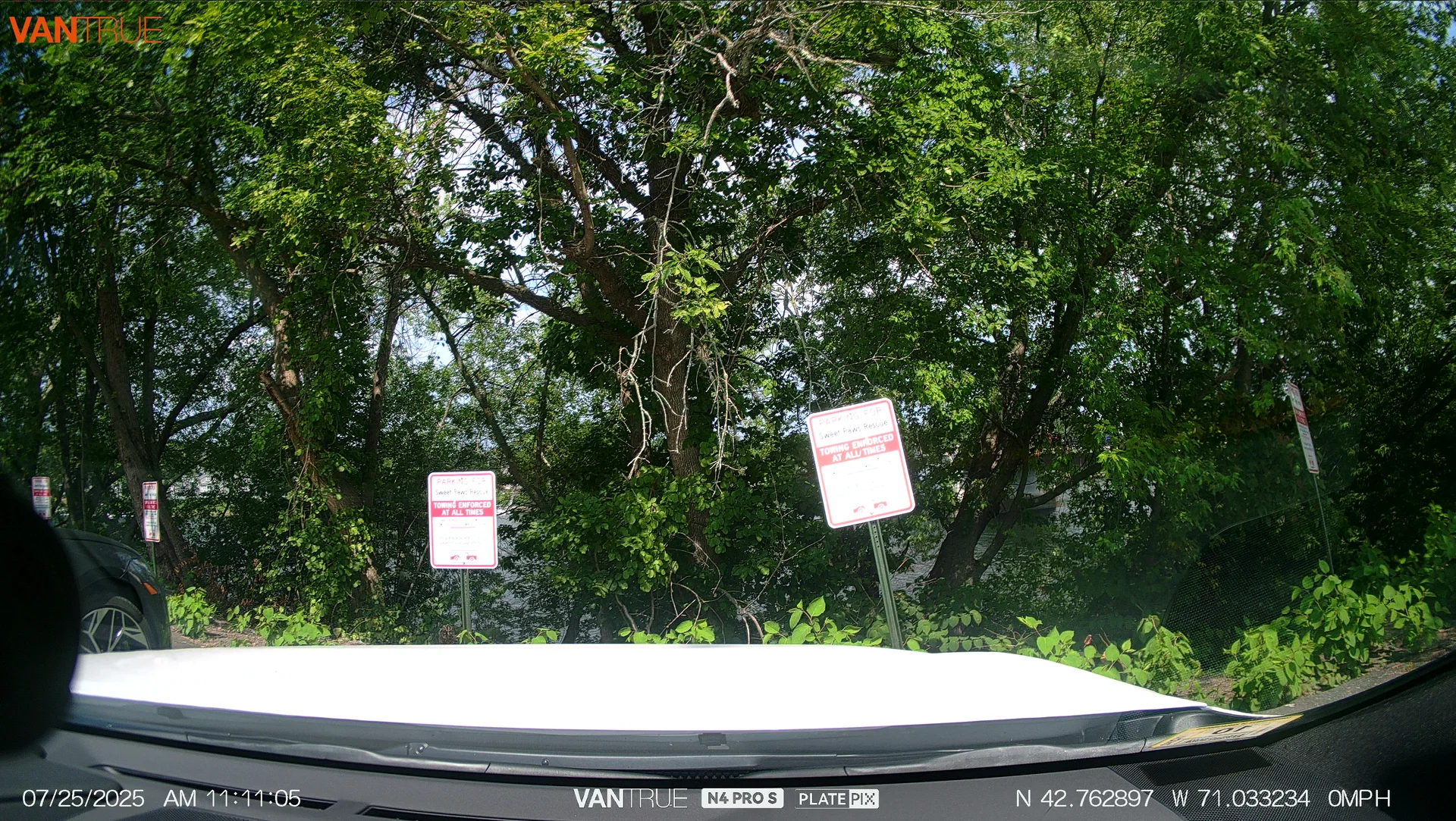

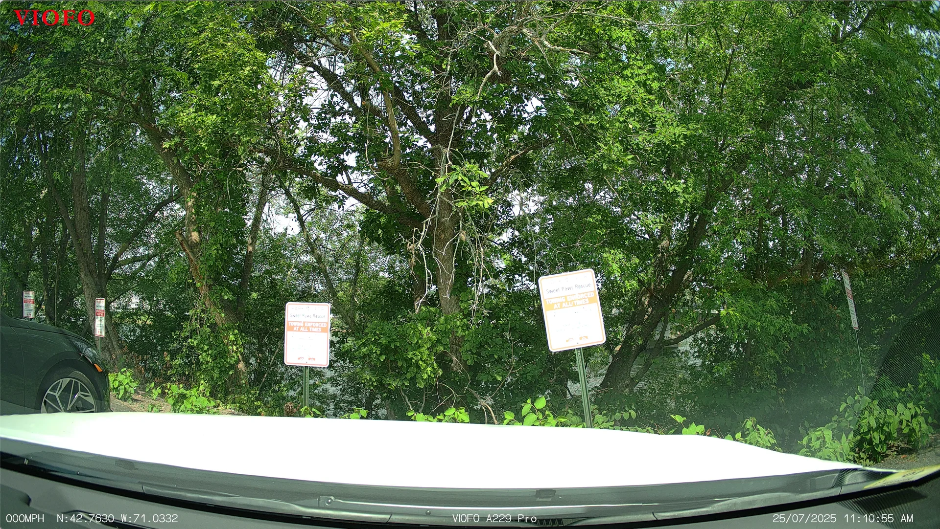

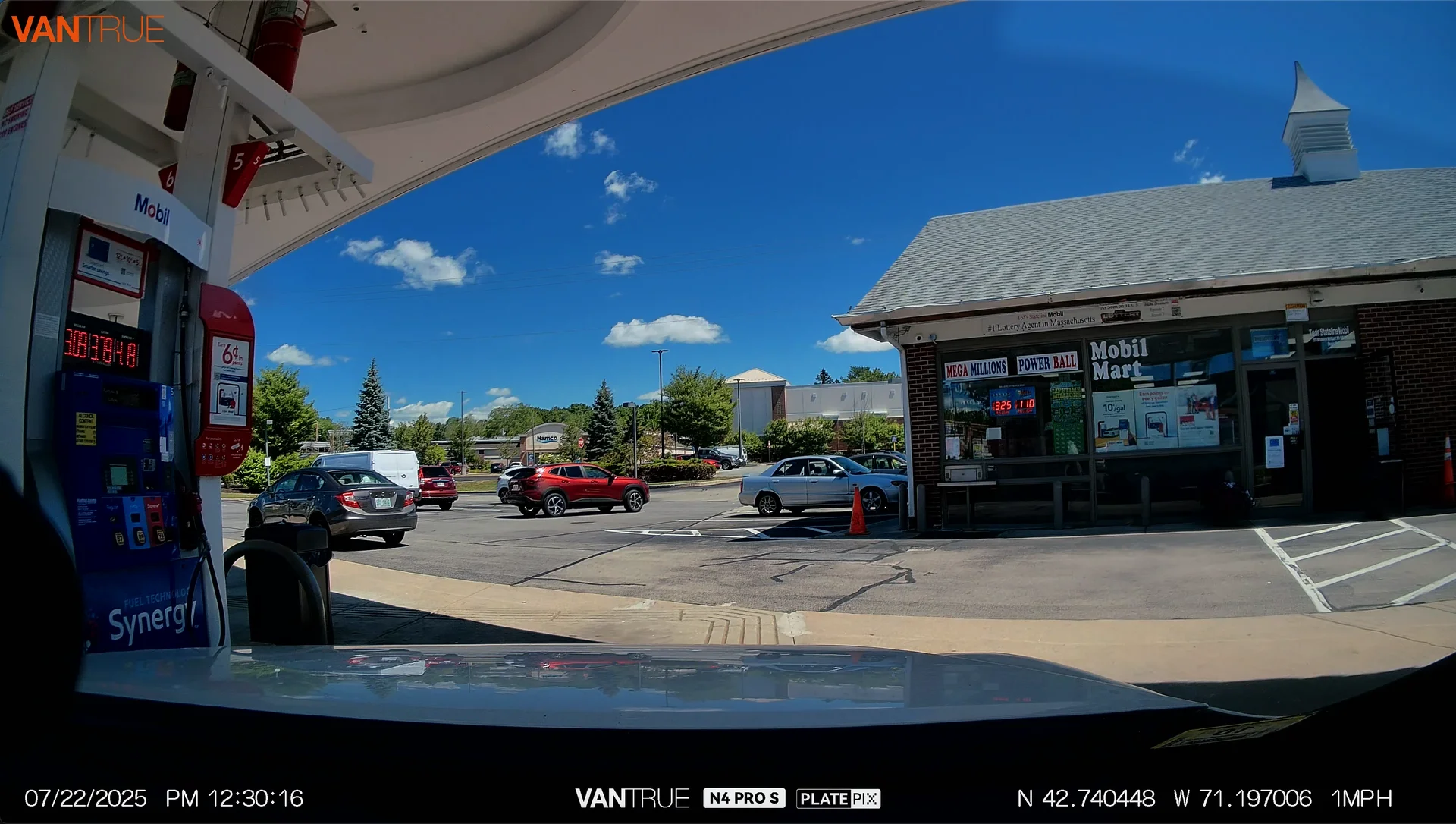

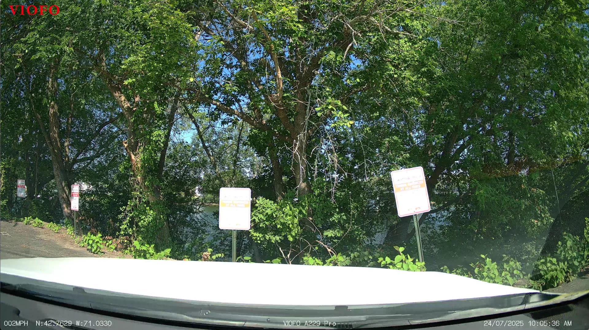

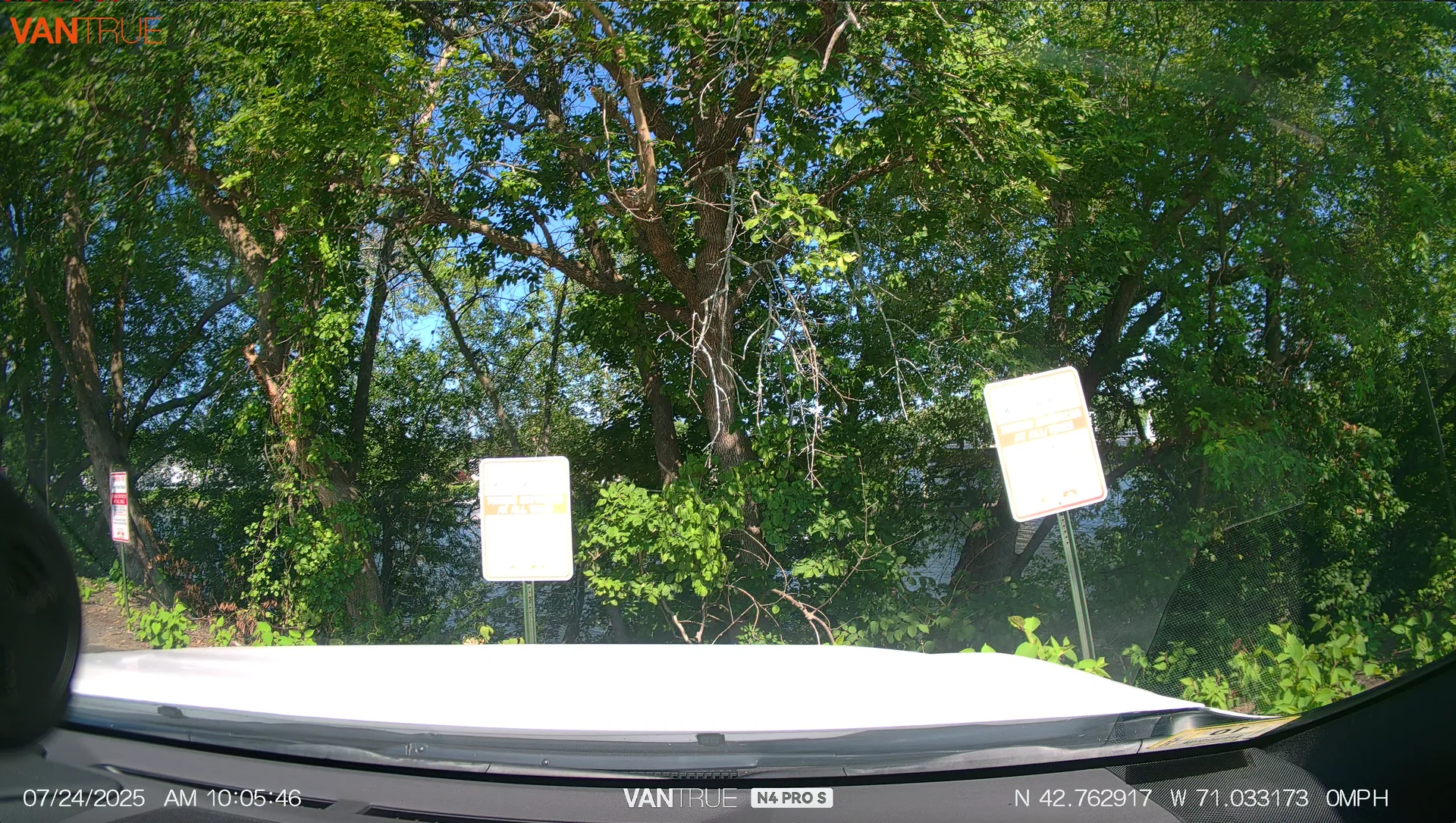

I think I found a lighting condition that definitely benefits from HDR and PlatePix
The sun was extremely bright shining on the two signs directly in front of my car and neither the A229 Pro nor the N4 Pro S could resolve them. The exact same signs can be seen to the left which are not directly facing the sun.
I'm going to try to get the same image again with PlatePix and HDR turned on
A229 PRO HDR OFF
N4 Pro S HDR and PlatePix OFF
That's an interesting comparison between the two cameras. It seems that the level of bloom/flare is greater around the two signs with the N4PS camera. I would think that is driven by lens choice more than algorithm choices.

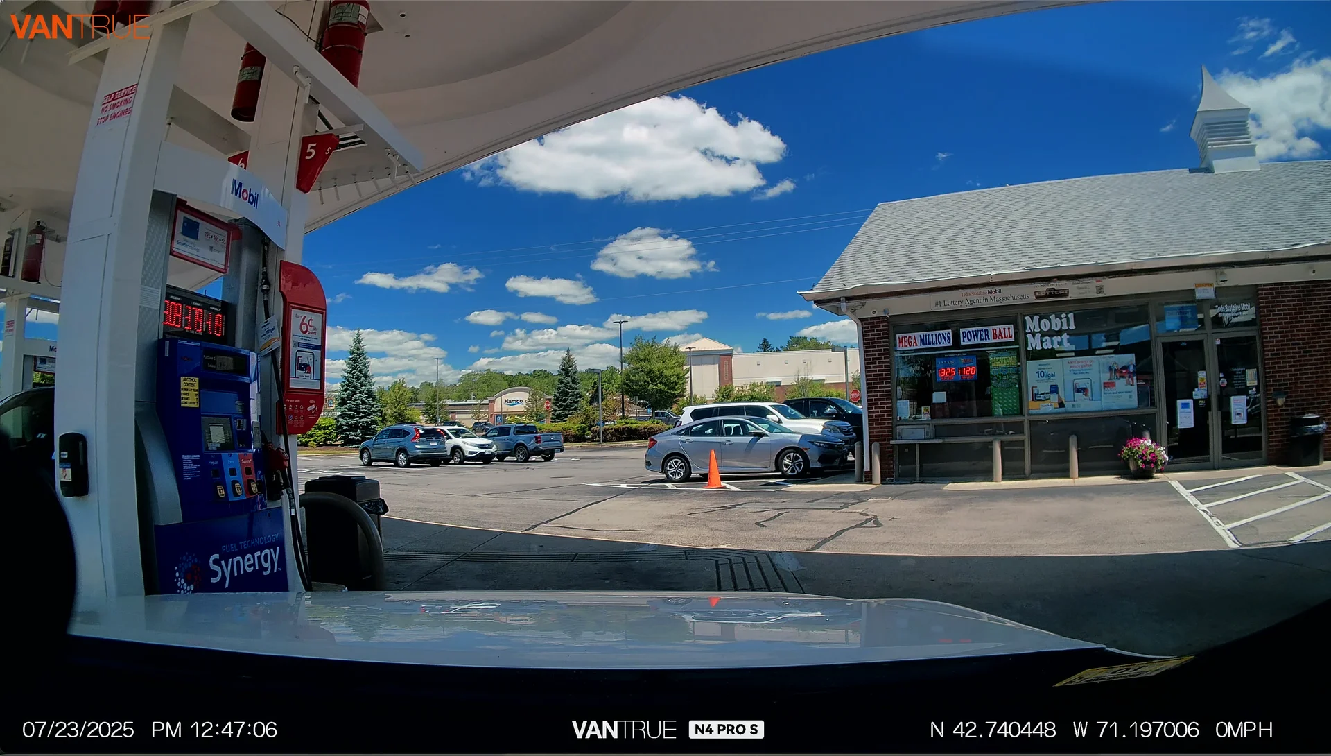

I took the same sign footage again today as previous post #51 under similar but not quite as bright sunlight conditions, but this time turned N4 Pro S PlatePix and HDR ON and kept A229 Pro HDR OFF. Both cameras have CPL Filters.
The Vantrue N4 Pro S with PlatePix ON definitely resulted in better readability of the highly reflective sign. Not perfect but definitely better than A229 Pro with no HDR.
The difference is that PlatePix darkened the washed out background color around the text and also brought to life some of the text not surrounded by background color.
A229 Pro HDR OFF
A229 HDR OFF

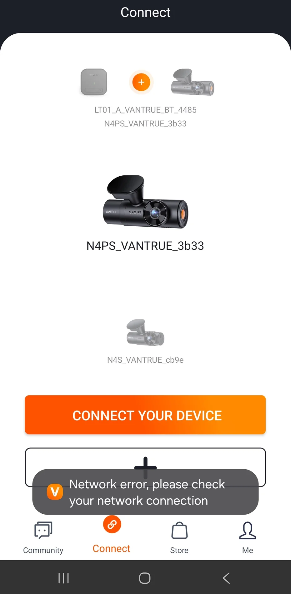

@Hack_man @EricSan @Jeff_Vantrue
I need you guys to test this out for me. Either my front unit is faulty or there's a major firmware bug in this camera. I can replicate this EVERY TIME after Camera Awakes from Low Bitrate Parking Mode following these steps.
A. Use the OBD II hardwire kit (hopefully you got this).
B. Set Camera to Low bitrate Parking Mode
C. Let the camera sit and enter parking mode for about 15-20 minutes
D. Start your car up (or don't) and try to connect to the camera via wifi
1. My Camera generates an error (Network Error, Please check your Connection)
2. The camera crashes and reboots itself.
3. The front and interior camera return, but the rear camera disappears (TESTED TWO CABLES WITH SAME RESULT).
4. Only way to make rear camera reappear is to unplug cord and plug rear camera cable back in. Sometimes need to restart Camera.
The Crashes occurs using the SAME method without the rear camera plugged in only recording Front + Interior. The only difference with 3 Channel (Front + Interior + Rear) is the rear camera drops out after camera crashes and reboots.

Collision Detect
Camera does not crash after parking mode, but loses rear camera feed after "waking up". I have to pull cable and reseat cable to restore rear camera.
That’s definitely an improvement in what I’d consider to be a maximum brightness situation. I’m doubtful ANY dashcam would be able to render that in a readable manner, especially given the relatively dark green overall scene.
