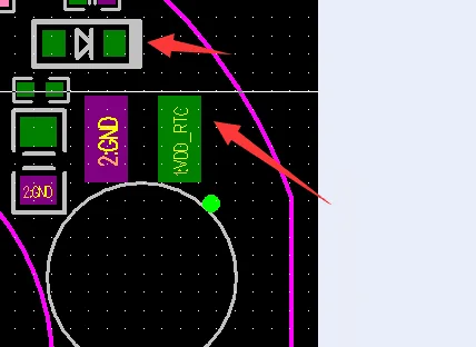

I suspect internal tablet battery. May be to small voltage to save date/time (2.929-2.771 V)? Sorry I am not radio man.
In my case both nanoQ's have the same date/time settings savings problem :( Every time, after 2-3 days of not using car,
must to check date/time in nanoQ before starting driving. If resets to default 2o16o1o1 - I will setting to current...
Hi,
I suspect internal tablet battery. Every time, after 2-3 days of not using car, must to check date/time in nanoQ before starting driving.
that happens on old batch 0903, the discharge current of RTC battery is too high so the RTC survive less than 2 days.
if you can, a DIY work will help (need some DIY solder skill and equipment):
1, take the battery + pin from PCB, use a heat resisting tape to insulate;
2, connect the battery +pin with the diode with a 220R resistor
that means add a resistor between the diode and battery, which will extend the RTC last time effectively.
<<of course, if you can't DIY, it is OK to send the the camera to our factory to repair>>
Hi it is a MS621 battery, or can use Double Layer Capacitor
the diameter is 6.8mm
