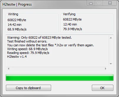

+1 for a VIOFO MLC
I've got two: 64GB and 128GB
They are fast cards.
VIOFO 64GB MLC
Write: 69 MB/s
Read: 80 MB/s
VIOFO 128GB MLC
Write: 66 MB/s
Read: 80 MB/s
I need another 128GB and was considering Samsung PRO Endurance as per their 5years warranty compared to VIOFO 12 months!
But Samsung seem to be a very slow U1 card (10MB/s)
I think I will go with VIOFO again!

+1 for a VIOFO MLC
View attachment 49371 View attachment 49372
