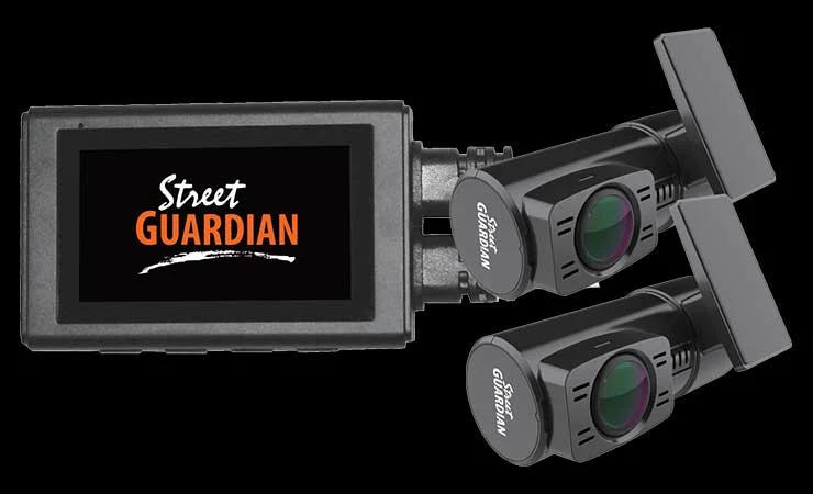

4 Channel cameras face several design hurdles. Both by car manufacturer and also by camera design.
Car Hurdles:
1. Not all Sedans have a fixed window. My Volvo Sedan has 4 doors that open and no place to mount. Hatchbacks, station wagons, and SUV's with fixed windows would be the target demographic. Trust me, I would love to have 4 channels.
Design Hurdles
1. 3 Channel cameras overheat in direct sunlight. For a 4 channel to be feasible, a design that mirrors Street Guardian's SD9663DR would be necessary. To have only the cameras mounted on the windows, and the main unit able to be placed in a shaded spot. 3 Channel cameras would also benefit from this design, too. Still don't understand why it isn't being implemented more often.
