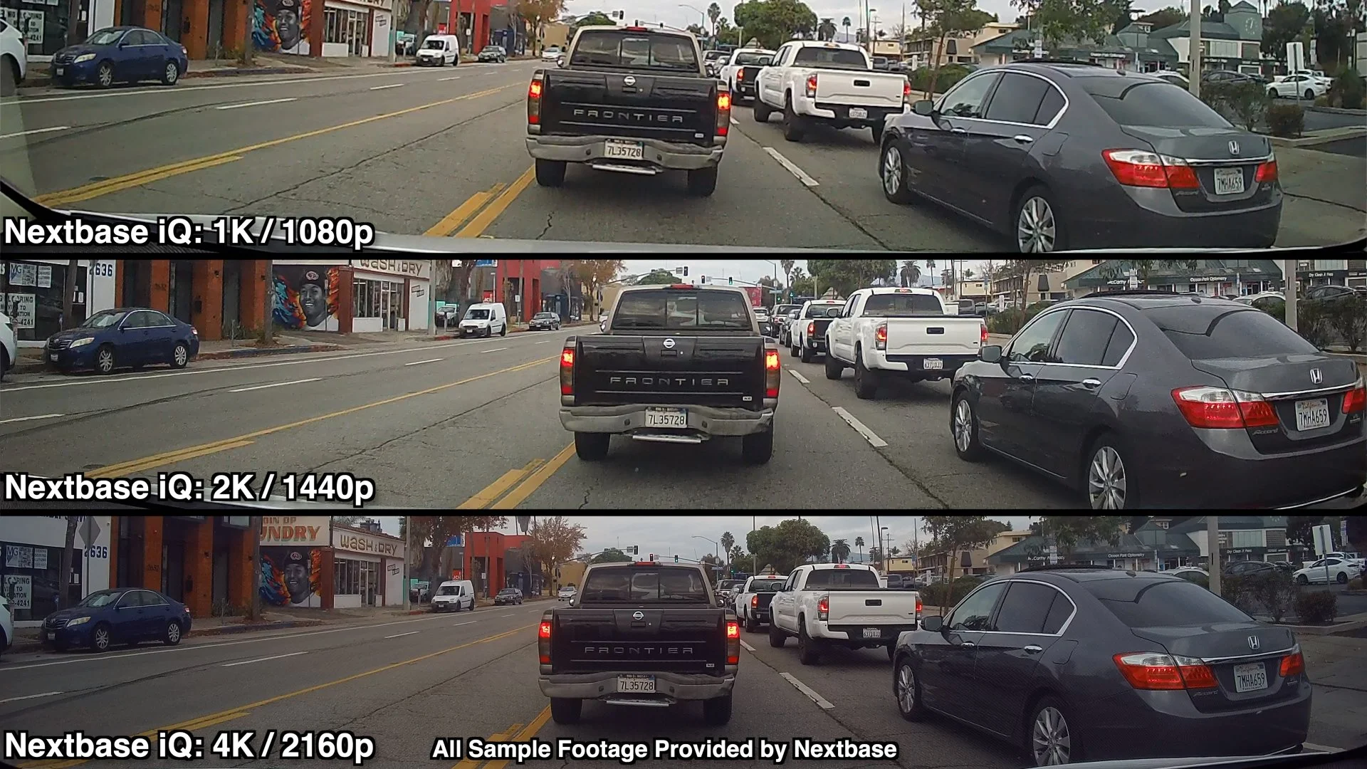

Here's a quick preview of what I'm working on. This is from a clip pulling up behind cars at a light:

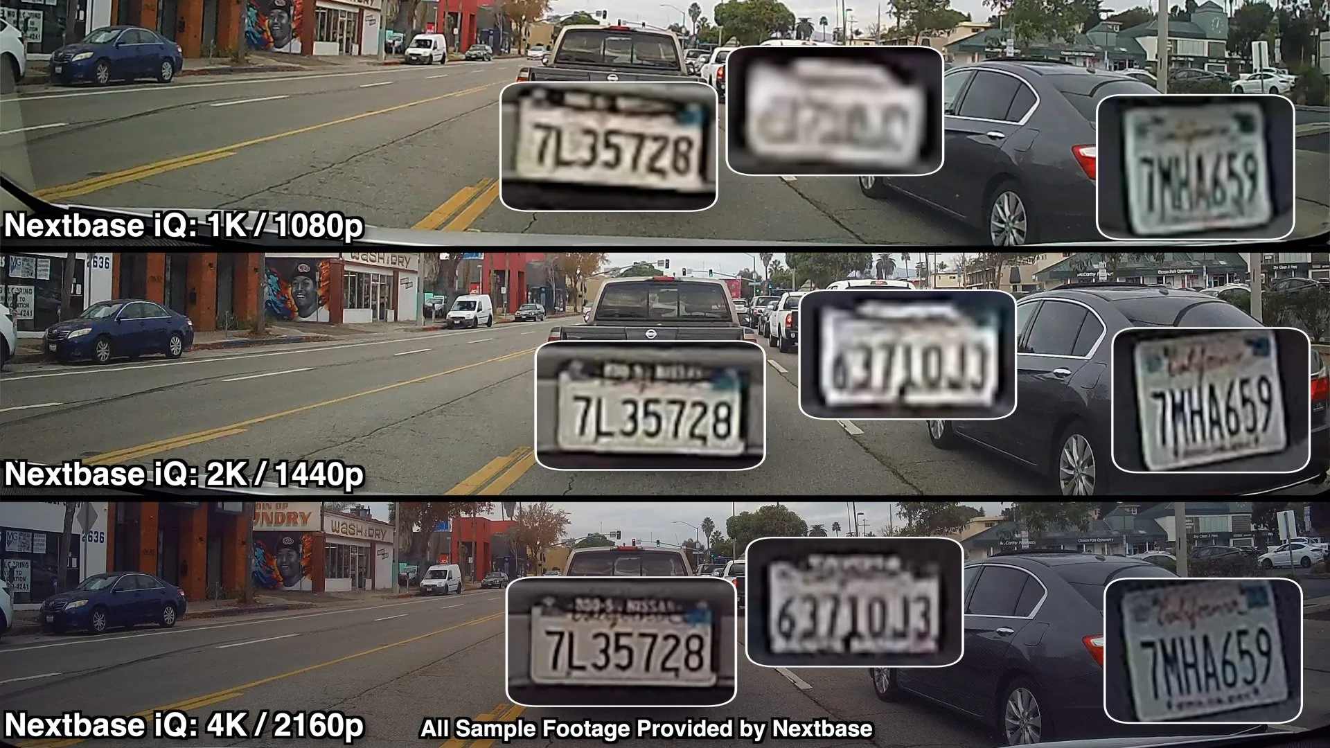

and here's how that looks with the license plate zoom-ins:

The 1K has the widest FoV? That seems the wrong way around, normally the 4K has the widest FoV, that is one reason for having a 4K!
The 2K and 4K have about the same number of pixels per licence plate? Not sure what is a result of your processing, I suspect something has been resized...
Makes it difficult to choose which one you want...
With the cloudy weather it is hard to judge the dynamic range, seems a reasonable image.
There is some noise from dash reflections, presumably due to no CPL.
The 1K has some colour noise in the road, as though it was too low bitrate.
The 4K has a magenta colour cast to the dark areas.

In terms of sample footage, all I have is two drives in cloudy weather. Nothing at night. Some of the footage is shakier than others. I'm not sure if it's due to the mount or what. Looking through things, again it doesn't seem like anything particularly standout, especially going down to the 2K or 1K models. When people start getting their own units in and can do some head-to-head comparisons with other models in different lighting conditions, that'll give us a much better idea.
