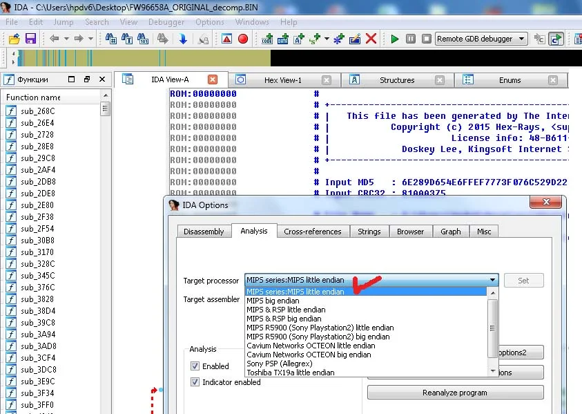

To which processor family does Novatek belong?
Of all the samples on IDA, i approached the MIPS architecture.
Is not it?
mips24kec 32bit little endian
Yes, load adress 0x80000000 afaik
