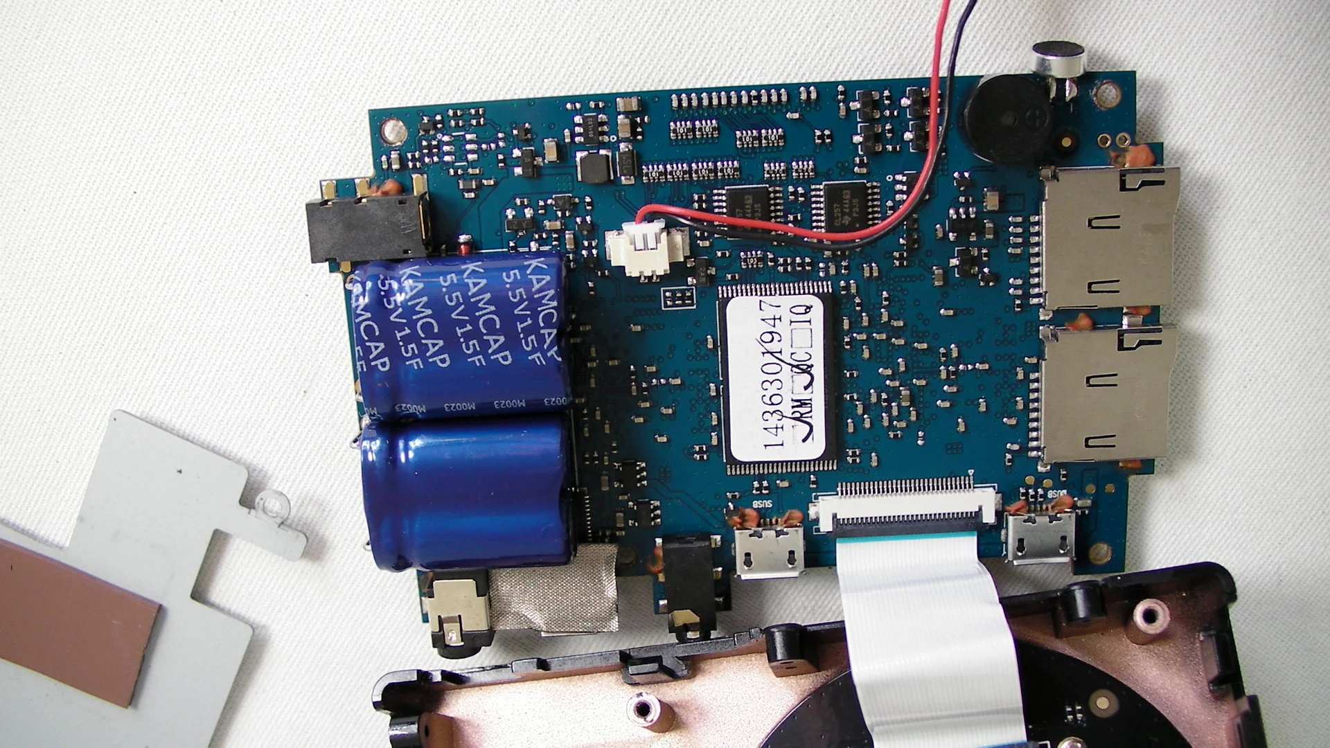

I am over 2 years on my Panoramas with the original Transcend cards. They still work but it seems that the capacitors are failing and my last file at shutdown is usually corrupted. I can live with it for now. Considering replacing the caps. Has this been done around here? I am going to look...great cameras though.
Supercaps can be de-soldered and replaced for the new one if you know basic soldering techniques.
You can buy them from eBay.

Thanks! Are there two? Is that link to the correct one for panorama IIs?
Panorama 2 uses same supercaps. You need only one set ( 2pcs taped together ).
Ah, my cameras are like new again! No more corrupt last file. Thanks again for the info and link!
