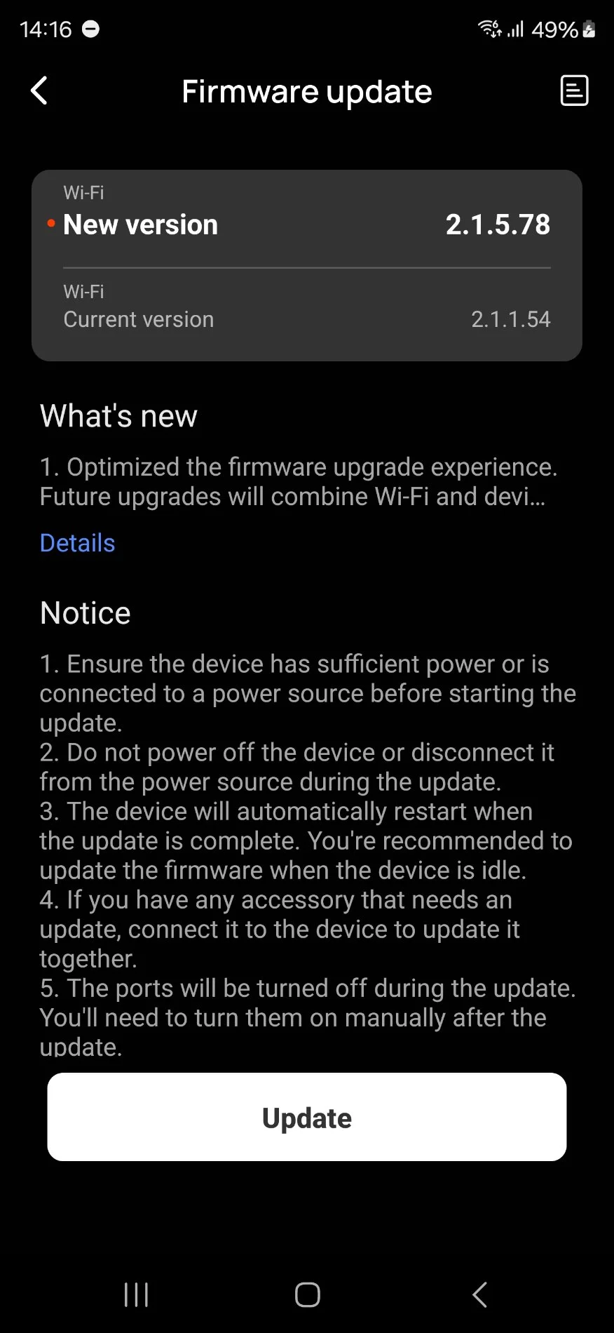

I'm curious to hear what the issues were... I did have some trouble updating the firmware to the previous version when I first received it. After performing the first firmware update, it reported that I was now on version 1.0.0.1 like you are showing above. This seemed odd after having performed an update. I didn't see any other issues, but then again, I didn't fiddle with it very much after I installed it, so I just might not have noticed. It seems that we are also using different hardware, which judging by your screencap, share some software...
