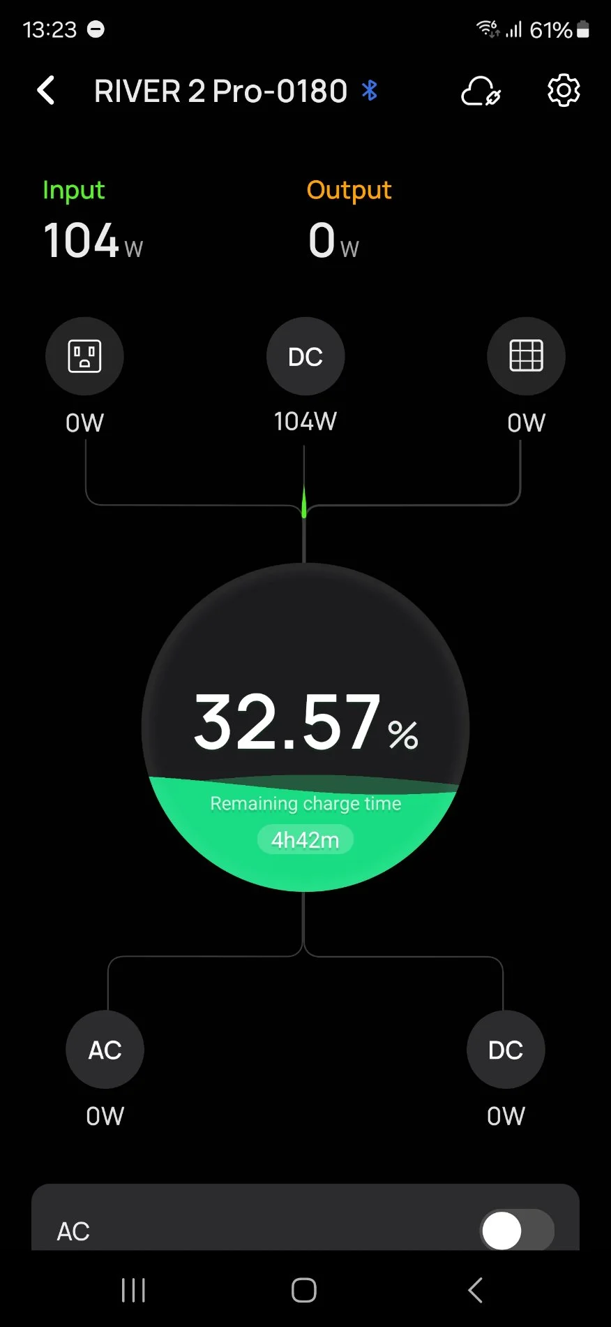

Looks like you can't charge the ecoflow river 2 pro via car or solar AND usb at the same time
Interesting
If I use the supplied car charger I get 104W charging, but does not work on solar charging
If I use my own made up cable which is not the xt60i-f cable I get 150w
The car cable supplied with ecoflow if xt60i-f and it's a thicker cable

The 89w instead of 100w for USB-C isn’t surprising. The difference is likely one of three things: the EcoFlow really can’t take 100w through that port, the power supply device isn’t capable of delivering a true 100w, or it is cable loss. Or some combination of the three - which seems most likely to me.
