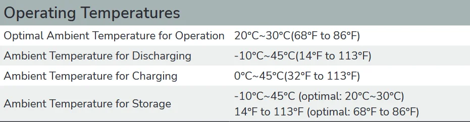

I just noticed the ecoflow has a charge limit from 0c while bluetti has -20c so it seems the ecoflow won't work for me in the cold Canadian winters.
Can you verify the bluetti charges at sub zero temps?
Might have to deal with the on/off with Bluetooth for the bluetti when its discharged.
All expensive Dedicated Batteries have the exactly same sub-zero charge protection/limitationHmm maybe I'll have to keep the battery in some kind of cooler to keep it from freezing or take it inside to warm up and charge in the cold winter days.
