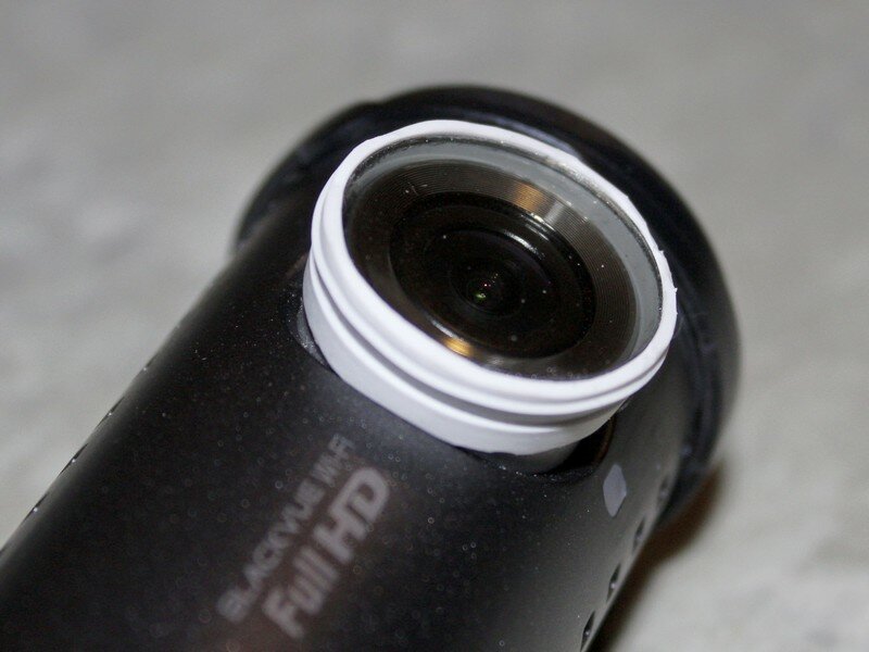

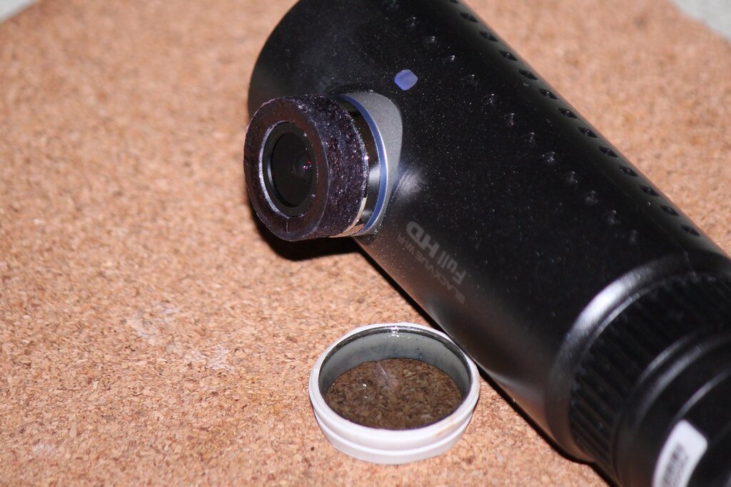

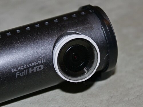

I have such a. A little altered
Does it fit well? Maybe filter should be little bit larger (28mm) or smaller (25mm)?

polarizing filter work
Mio... What setup did you go for? Got some links and a small How-To?
yeah Mio, I want to know exactly how you did that and what you used and how you did it. video would be great on how its done like do you need to remove existing lens or is the filter put on top of it?? I know nothing about this.
lens - BL03618BIR-WF
the viewing angle, the same as on the DR400
Cons - a little longer, and looks to the DVR
The filter is there, I insert it into the lens. It can be worn on the original lens
let me get this straight, the white part in the photos of yours with the glass on it is the polarised lens? and that can just sit over the original lens? correct?
but there is an option to replace the entire lens of the camera with the one in the link above that I don't really want to do.
where do we get this polarised lens from? the white part with glass sitting next to the camera I your photos? do you have a link for this?
