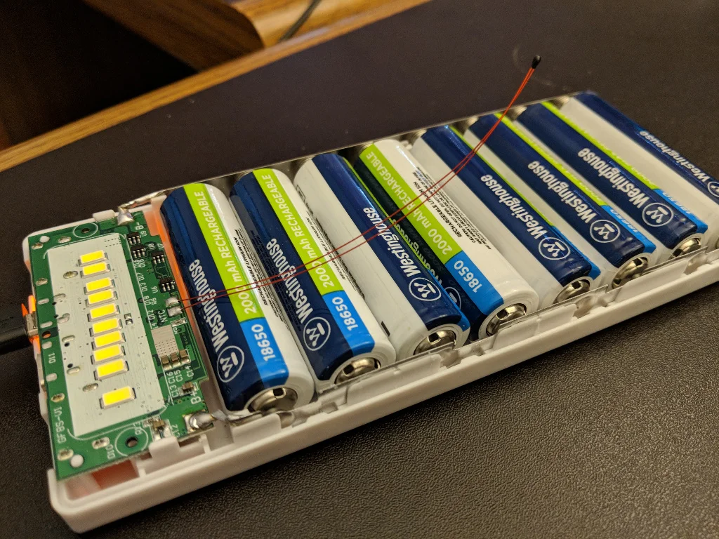

20.000 MAH setup ( 2600 mah batteries )

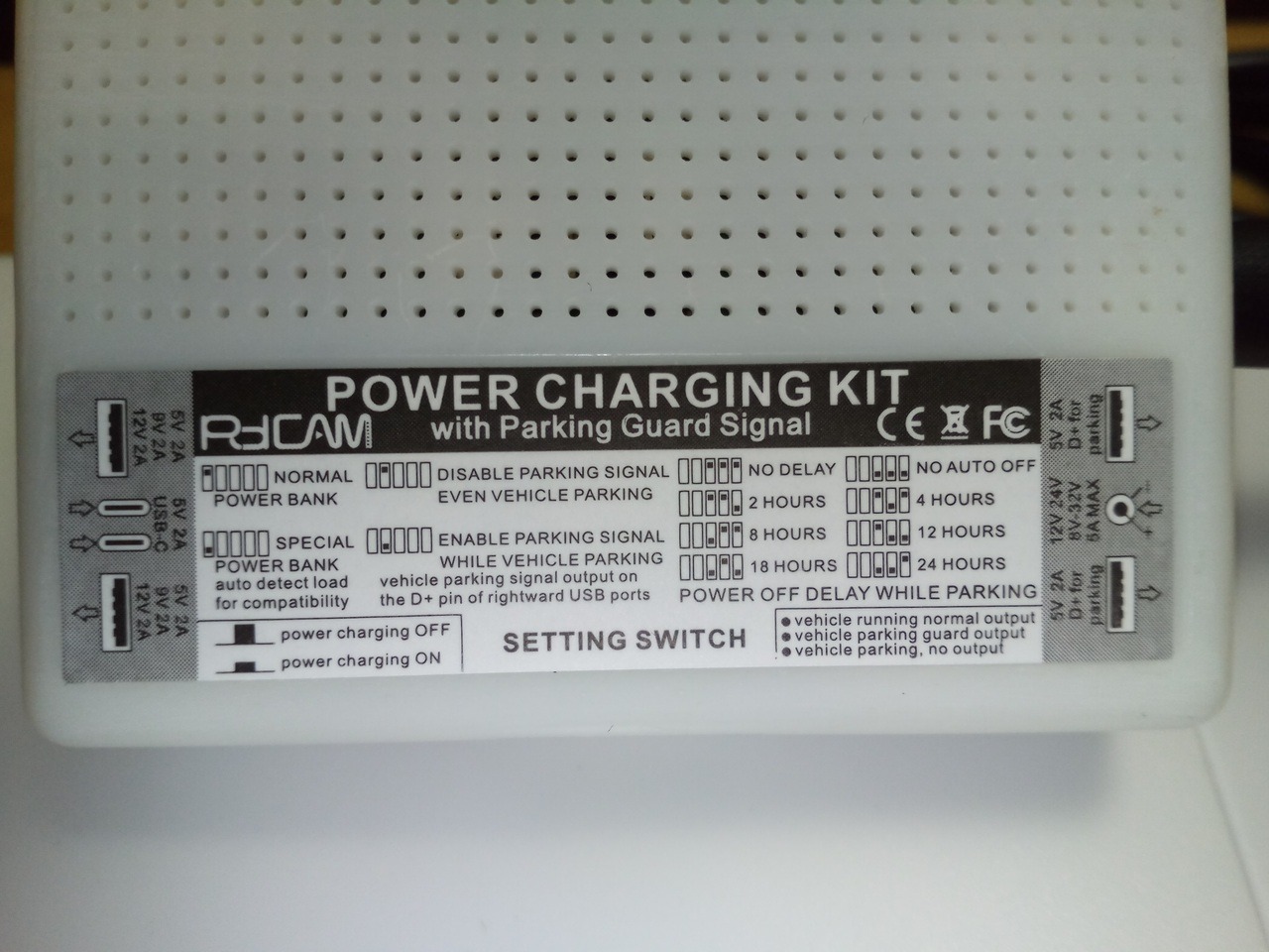

The timed mode is adjusted by the little switches on the side, right? So, it means if I set it to 2 hour (I think that's the default), power will be cut off in 2 hours after car shuts off, is that right? thanks!
Yep thats it, your options are : 2 - 4 - 8 - 12 - 18 and 24 hours + "No auto off" meaning it will keep going until the power bank have to stop due to low voltage to protect the batteries in it.
There are also a "No delay" setting, i have no idea what that are, but its on the 3 dip switches that set the cut of time, but i assome this cut out the batteries so it just function like a regular dashcam PSU only supplying power to cameras when the car are on.

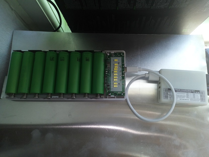

I did a charge test ( quick charge ) overnight on my 8 X 2600 mah ( 20800 mah total ) power bank.
The power bank was run down until it itself shut off, it was then plugged into the little box along with the mobius maxi so it could log when the power bank was full.
Started charging 02:23 in the morning - video footage indicate charging stopped 08:50, so 6.5 hours you have to drive to replenish a empty large power bank.
Now i have never recharged such a large battery before, but it seem to me like my phone quick charge are faster, factoring in it just have to recharge a 3000 mah battery.
So next order of the day will be to try my phone charger on a empty power bank and see how fast that is.
6.5 hours do seem a little slow, i drive that "much" in 2 weeks, maybe even 3 weeks.
So it seem a bit slow to me with 6.5 hours. ?
Anyways the quick charge are on, this the power bank also indicate with a blue LED, and the 2 are wired up to quick charge.
PS. The "thing" would probably charge faster without carrying the mobius maxi too, but i figure this is the way it would work in peoples cars.
PPS: It seem like i got 27 hours of Mobius Maxi runtime out of the 20.800 mah power bank, i am about to do a closer inspection of the batteries as the ones i use are flat top and may not be optimal at least not around the middle 2 batteries, but more on this later on.
