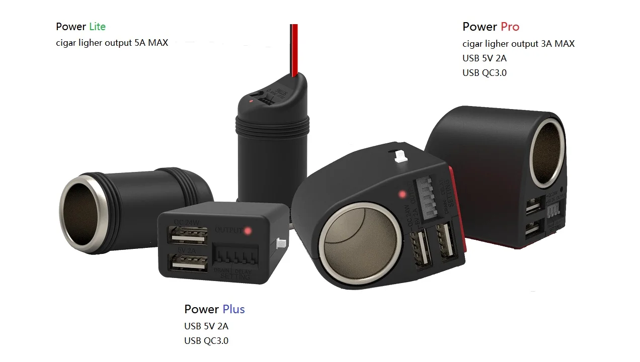

alternative of Power Magif PRO
Power Lite: enhance your cigar lighter charge to be a hardwire kit with parking delay and battery drain protection
Power Pluse: replace your hardwire kit to be a intelligent one with parking delay and battery drain protection, plus a QC3.0 24W output for mobile device recharging
Power Pro: combo of Lite and Plus, most powerful and intelligent power supply device in vehicle with parking delay and battery drain protection
series features:
1, auto 12V / 24V detect
2, parking delay timer + Parking battery drain detector
3, auto driving/parking detect
4, Auto Start & Stop detect
5, Auto high temperature protect

alternative of Power Magic PRO
Power Plus: replace your hardwire kit to be a intelligent one with parking delay and battery drain protection, plus a QC3.0 24W output for mobile device recharging
series features:
Do all 3 take power direct from the fuse box? I don't have always-on 12v sockets.
yes from fuse box, with Piggy-back fuse
