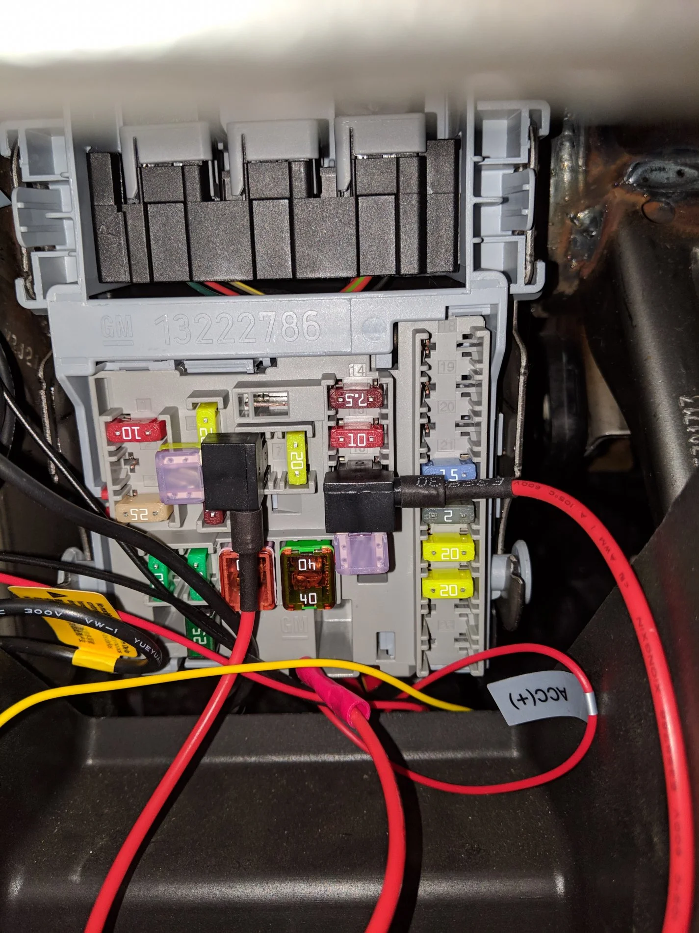

Thought I would share this.... I can not find -anything- on my cruze, so did it all myself.
2015 Chevrolet Cruze LTZ, power everything. My Blackvue DR900s-2ch I installed with the PMP, I have the red wire add-a-fuse'd to the power outlet(#6), and the yellow wire is add-a-fuse'd to the trunk latch fuse(#16), NOT the relay, high in the fusebox. It turns on and off exactly how it's supposed to. I previously had that problem it wouldn't turn off, so it turns out I had the yellow wire fused to the audio fuse, that was a mistake. Now, if I could only find someone with my car, to tell me about the installation of a mirror tap for my Escort.... power mirror, onstar, auto-dimming. πŸ™‚

Welcome to DCT @SandmanXX πŸ™‚ and thanks for sharing the info. Hope you get an answer on the Escort soon!
