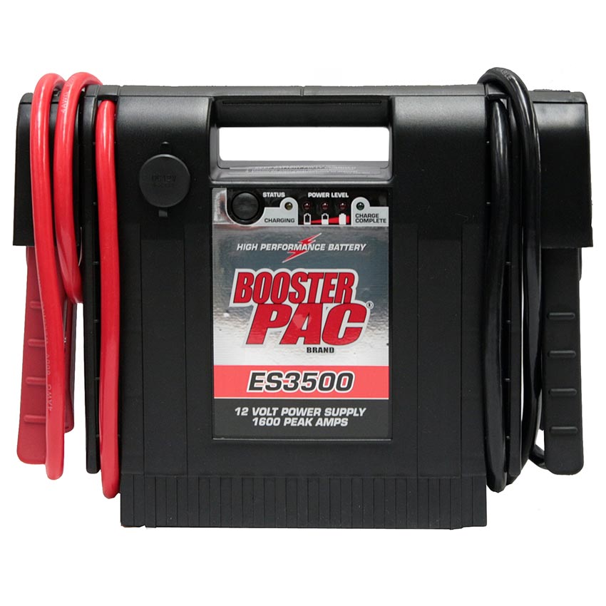

What about one of those jump-start boxes that have a car cigarette lighter outlet in it?
You have an emergency jump-start source and a long time continuous power source for your dashcam? Depending on where you store it you may need a long power cord for the dashcam.
Well, those would do the trick but they are rather big. It would be similar to carrying an extra car battery in your vehicle.
Another option might be one of the very small jump starter packs like the 6.5 x 2.9 x 1.2 inch PowerAll. These can be used as general USB chargers the same way as these battery banks we've been discussing but they can also jump start a 12V vehicle. One of the differences here is that the 12V chargers are vastly more expensive than a USB battery bank. The point of these USB battery banks is mainly that they are inexpensive and convenient. For the cost and hassle involved with a jump starter it may well be better to hardwire the cameras or modify the 12V socket in one's vehicle to full time power with a voltage cut-off device to protect the car's battery from dropping too low.

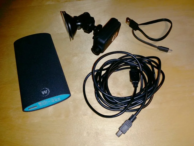

I change vehicle every day at work, sometimes even during the day, therefore I can't make any modifications or fancy installations - this is my survival kit:
a mobius with suction mount
a 10.000 mAh powerbank picked up at my local electronics dealer (it has a 2,1A output and enough juice to last 3 or 4 working days)
the 3m cable mobius came with
a micro usb-cable for charging my phone or bluetooth headset if needed
You can see the size of everything. It goes perfectly in my company bag (but not that perfect in the pockets of my jacket, still that's an option too), and hooking it all up is just a matter of seconds... just as taking it down again.
