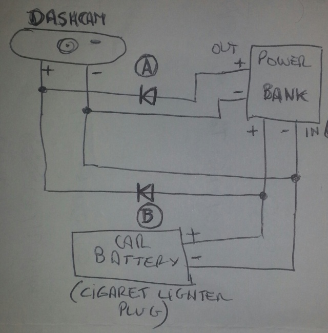

Considering my previous post, I thought about using 2 diodes to allow charging power bank and run dashcam at the same time when car is running.
DIODE A : Allows powering dashcam from power bank source during car parking and blocks car battery power on the OUT plug of the power bank when car is running.
DIODE B : Allows powering dashcam when car is running and avoid power bank IN to be powered from power bank OUT when car is parking.
What do you think about this ?
I'm just a noob with electronic circuits 🙄
a relay is the way to go ...
you would still be charging with your circuit as A diode would let the power out !
"A" diode will let power out but my power bank does not allow OUT when IN is used.
A relay is probably a better idea but I don't know how to wire this.
Any help with scheme ?
I guess you mean 5V relay ?
A 12v relay will do..
when the ignition is on it is used to break the supply circuit from the power bank out and when the ignition is off the relay drops out and makes the circuit from the power bank out ...
Couldn't my electronic scheme be a solution to avoid charging and discharging at the same time ?
Looks good to me, except:
1. My powerbank doesn't switch the output back on when the input power is removed - I have to press the on button.
2. Most diodes with sufficient current capacity will drop the voltage by 0.8volts at the sort of currents used by a dashcam, the result may be too low for some dashcams, no problem for an 0806 though.
3. presumably your "car battery" is 5volts and turns off when parked, otherwise it won't work.
I think I would use the diodes rather than a relay if the above issues aren't a problem.

It sounds like a hardwired set-up to run your cameras off the 12V circuit in your car would really be a better solution for your particular needs.
By using some relays, the setup will be much more complicated.
5V relay needs less wires as it could be placed near the power bank :
You've got it more complicated than it needs to be. Flip the relay around so it's output pole is connected to the dashcam. Then the NO pole connects to the same 5V charger going to the power bank and the NC goes to the power bank output. That gets rid of the extra 5V adapter and extra wires.
KuoH
Hmm sorry I do not understand what you mean...
Are you able to make a scheme for me ?
Just a quick cut and paste, but you should get the idea.
KuoH
Everything is clear now ! thanks !
