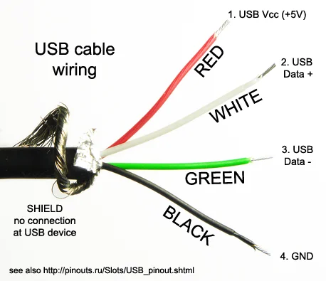

I have a power bank that makes a Mobius think it is connected to a computer and forces it to go into standby mode rather than begin recording. Some "smart" power banks will cause this issue unfortunately. The solution has been to modify the existing cable by cutting the white and green data wires while leaving the red and black power wires intact.( You will probably need to completely isolate the shielding from the connection as well.)
Edit: Use heat shrink tubing to complete the modification and end up with a decent looking repair.
If you happen to have a short spare USB-A to mini-B cable around you can try this fix-it out and see if it works for you before committing to the cable you want to use on your bike.

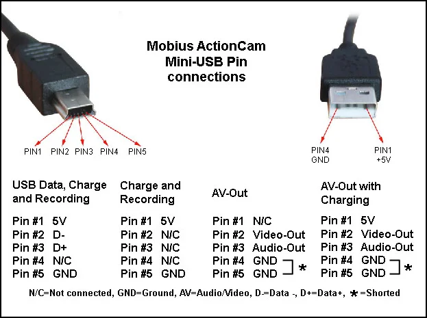

The photo I posted above showing the wire colors you will find in every USB cable along with this pin-out chart will explain the differences between a USB data cable and a standard power cable.
If you put a temporary piece of tape over the two inner pin connectors (pin 2 and pin 3) on the USB-A plug you can test to see if the Data connection is your problem.
