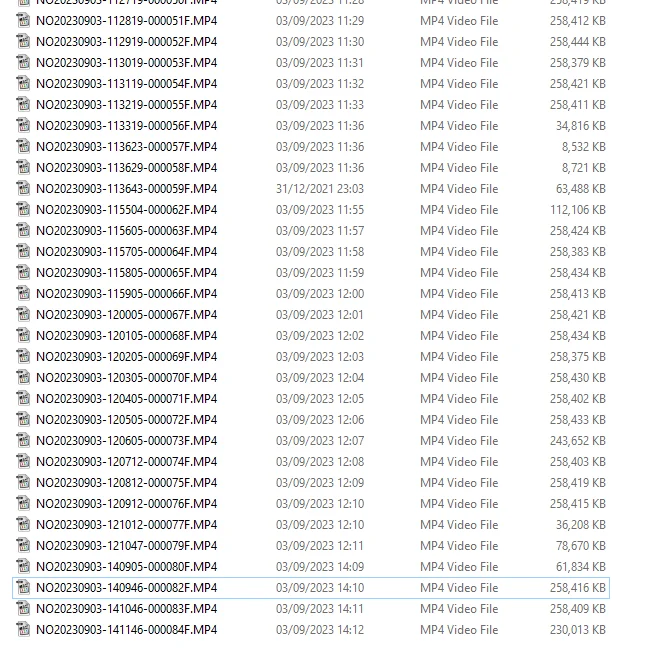

Oh yes, I would put a cap on those events but normal recording should be allowed to take 100% if there are not events
