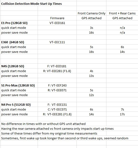

I haven't finished this yet and I'll update it when I can fill in the holes, but here are some start up times from Collision Detection Mode that I made earlier today.
EDIT: I updated the table with the SD card size that is in each camera and the firmware version of each camera. The fastest wake up time that I observed was with the S1PM camera (~2.3s) that had an empty 128GB SD card in it at the time.
