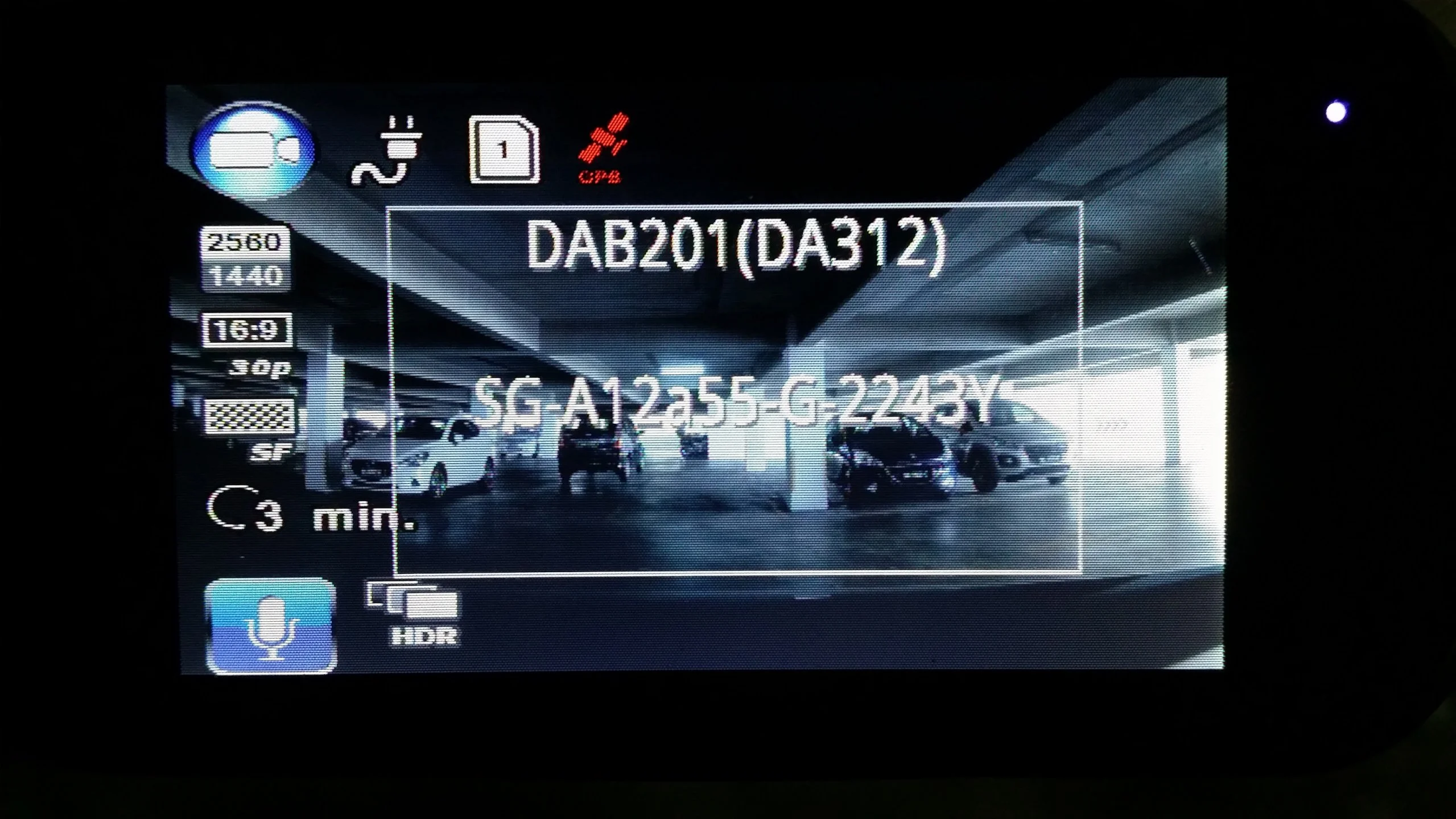

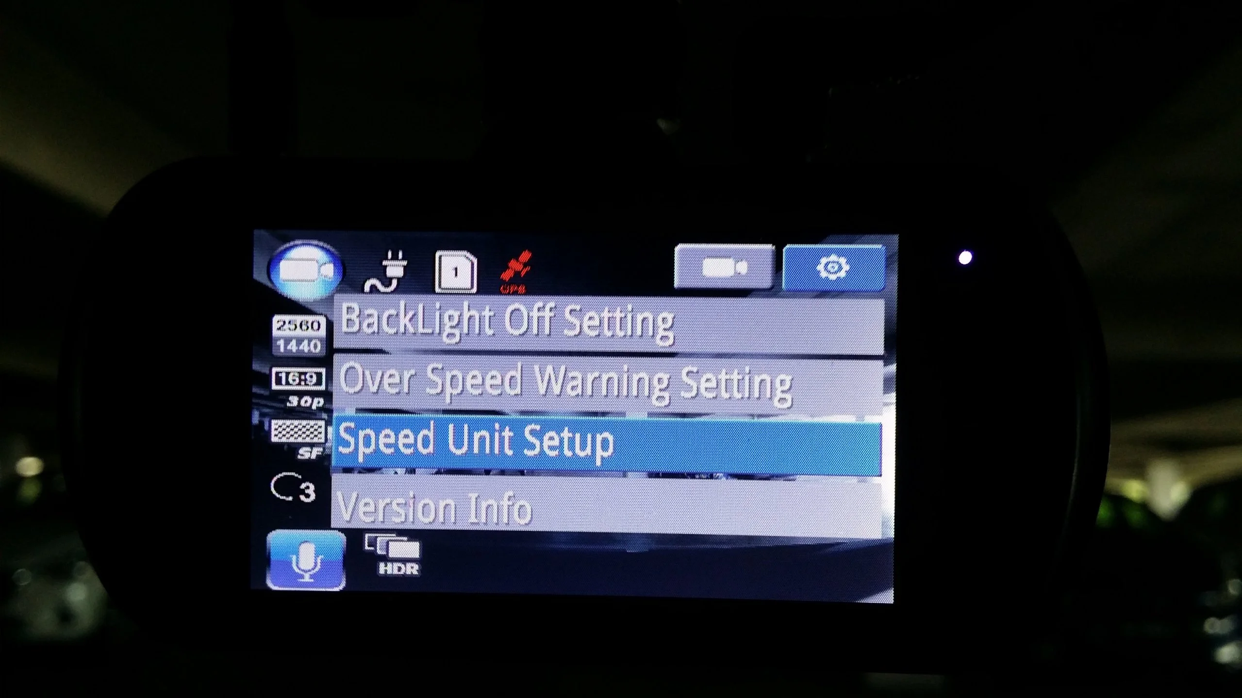

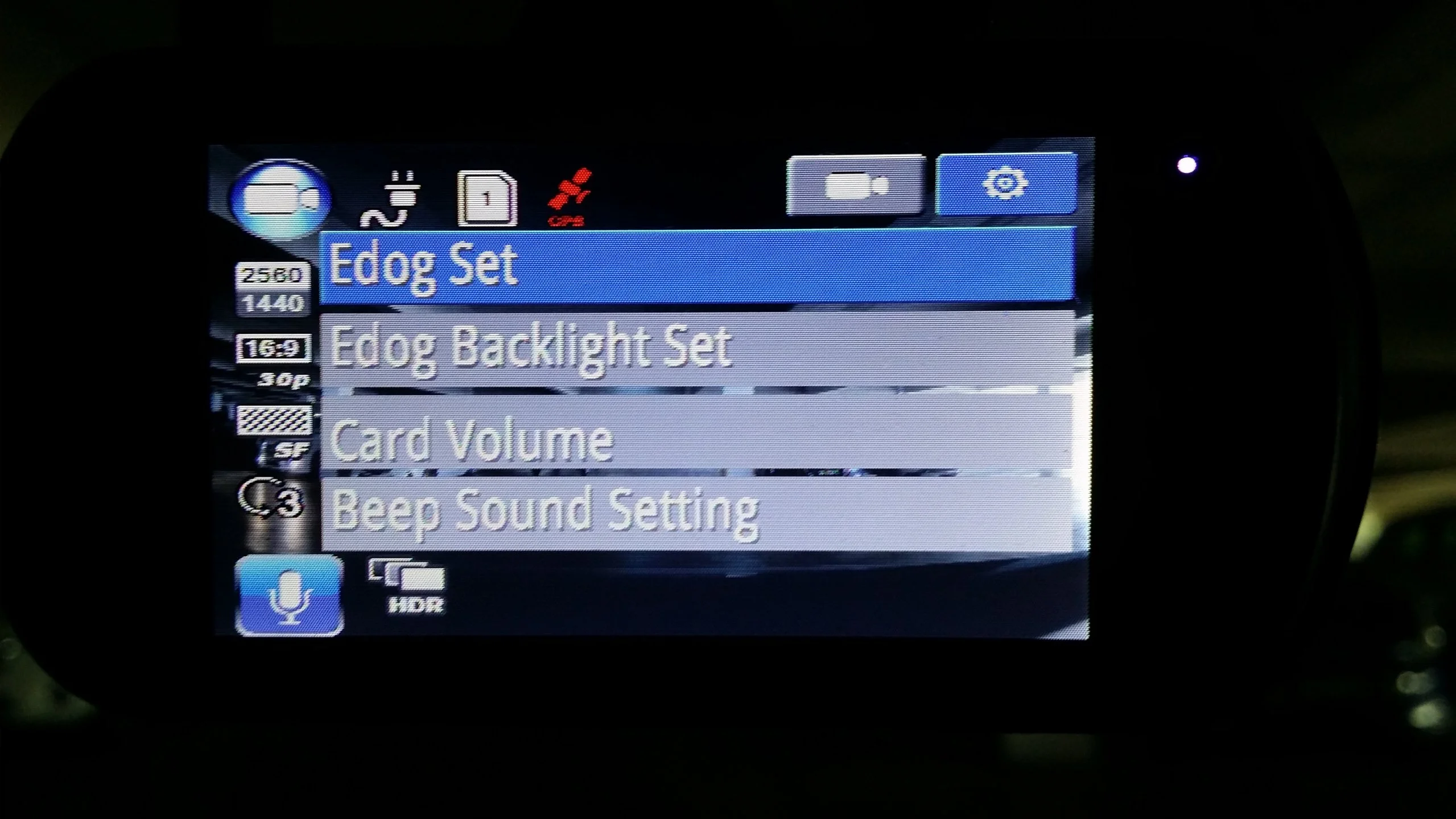

Updated...
Now can choose between kmh or mph
2 new edog settings
