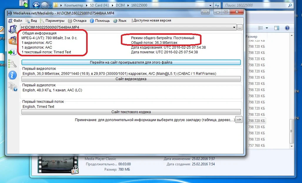

Firmware " 2135 " , the video resolution 2560 * 1440 , HDR on, 30fps:
The modified firmware to contact:
Falsificator
Here's firmware 2135 high bitrate from Falsificator thanks to him !
Download:
https://drive.google.com/file/d/0B2ALNf0PoOGKTXEtRGY4NExPeTg/view?usp=sharing
Ok, thanx again to you and to Falsificator. I try it tomorrow, on good light, until now I have just night films and rain days. I think the hi bitrate is influenced yo hi values by good light and more details on film or this is not important? I think that still images would look better if we could set the brightness higher. Any thoughts on this? Or hopefully the emergence of more complex firmware and user generous. Thanx again. Alex
Download:
Thanx man, it work, I have now around 40Mbs bitrate, THANX AGAIN. Insist with a question: while a menu with more settings (an example in my country speed in the village is 50 kmph, the current menu allows settings than over 70kmph), mainly related to brightness, I think is a place of more settings. Who perfected this firmware? Respect for these people.
