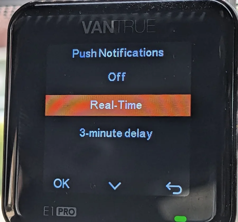

Push notifications are set to real-time (this has to be set using the camera on-screen menu - it is not in the companion app).

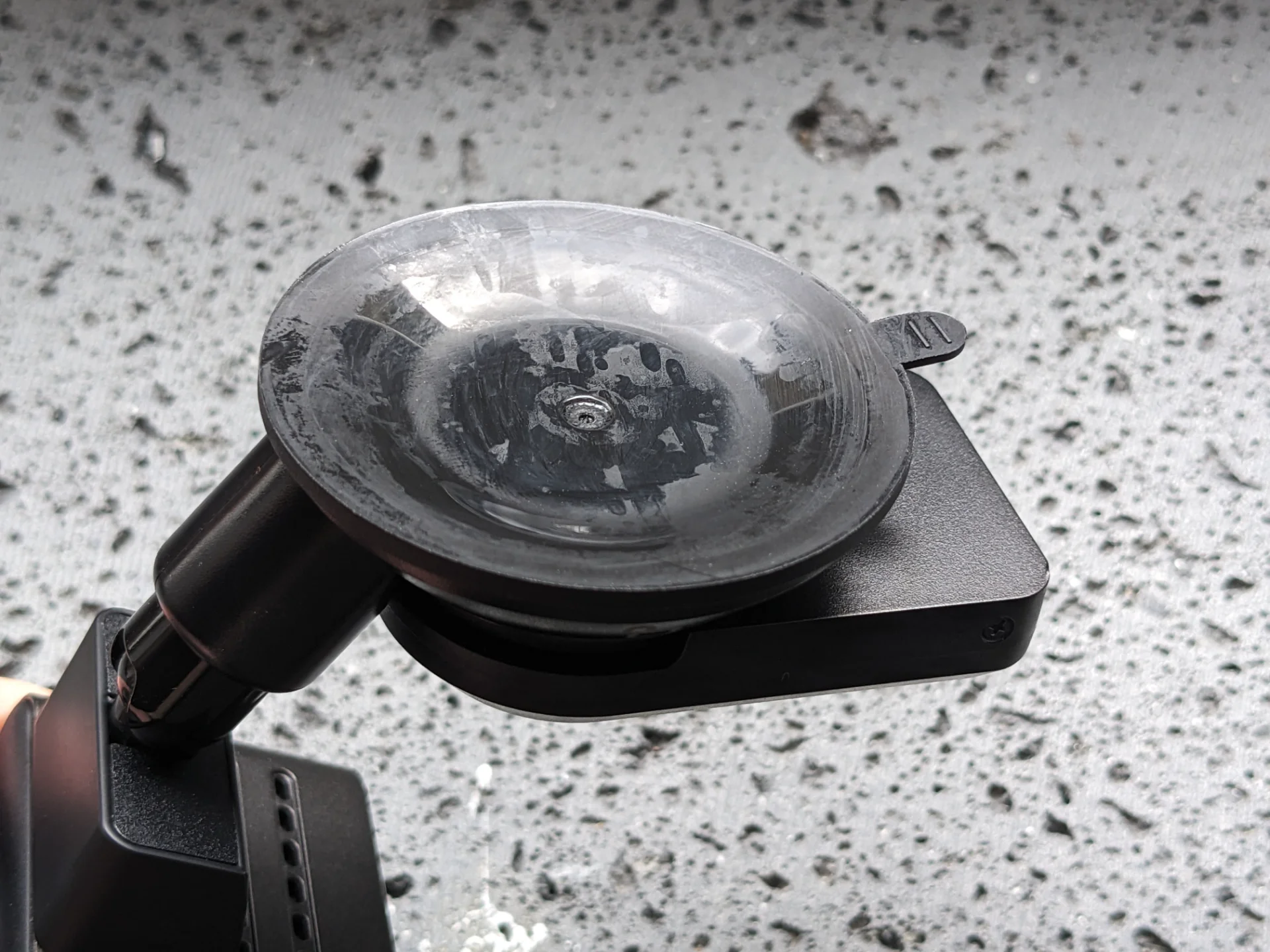

I'm on vacation this week and I brought the E1 Pro with me to use in the hire car, with the suction cup mount. Unfortunately the suction cup keeps falling off the windshield 😕
The first time it fell off after only an hour of driving from the airport. The other two times it fell off when I left the car parked overnight.
It seems to have a firm grip when installed by twisting the locking mechanism 90 degrees. The glass is clean and does not have raised dots in the area where I am installing it.
It has been about 9 months since I used this mount. It was stored in its box. The protective cover for the suction cup came off and no longer 'sticks' to the surface. Perhaps the material has aged?
@Jeff_Vantrue
I see patterns of "something" in the light reflection on the cup itself. run the suction cup under water (careful to keep the rest dry) and rub with your fingers to make sure it is clean and there is no physical debris stuck to the cup. Then let it air dry. This will remove lint and other things that might be stuck to the cup. Don't dry with a towel of any kind, that will just impart more lint. Lint keeps the suction from forming. I've run into this lots of times with radar detector suction cup mounts. If this doesn't work, then there is another problem.
@Jeff_Vantrue
Sorry to hear about the mount issue.
You can try restoring the suction by soaking just the rubber suction surface in boiling water for a short time, then cleaning it with alcohol. This can help improve its stickiness.
Please be careful to only soak the rubber part, do not immerse beyond that area, as the mount isn’t waterproof and water could damage the internal components.

The issue might be user error 😳
I thoroughly cleaned the glass before re-installing the mount and it's stayed on all day today.
I partly blame the hire car company for not keeping their car spotless!
I rubbed it with a wet lint-free cloth that I found in our holiday house and it still has that patterned appearance. I didn't try boiling water though.
I'm on vacation so that might be difficult. I have half a nice bottle of wine and a strong German beer available...!
The suction cup has remained solidly secured to the windscreen since I thoroughly cleaned the glass prior to re-installing it.
