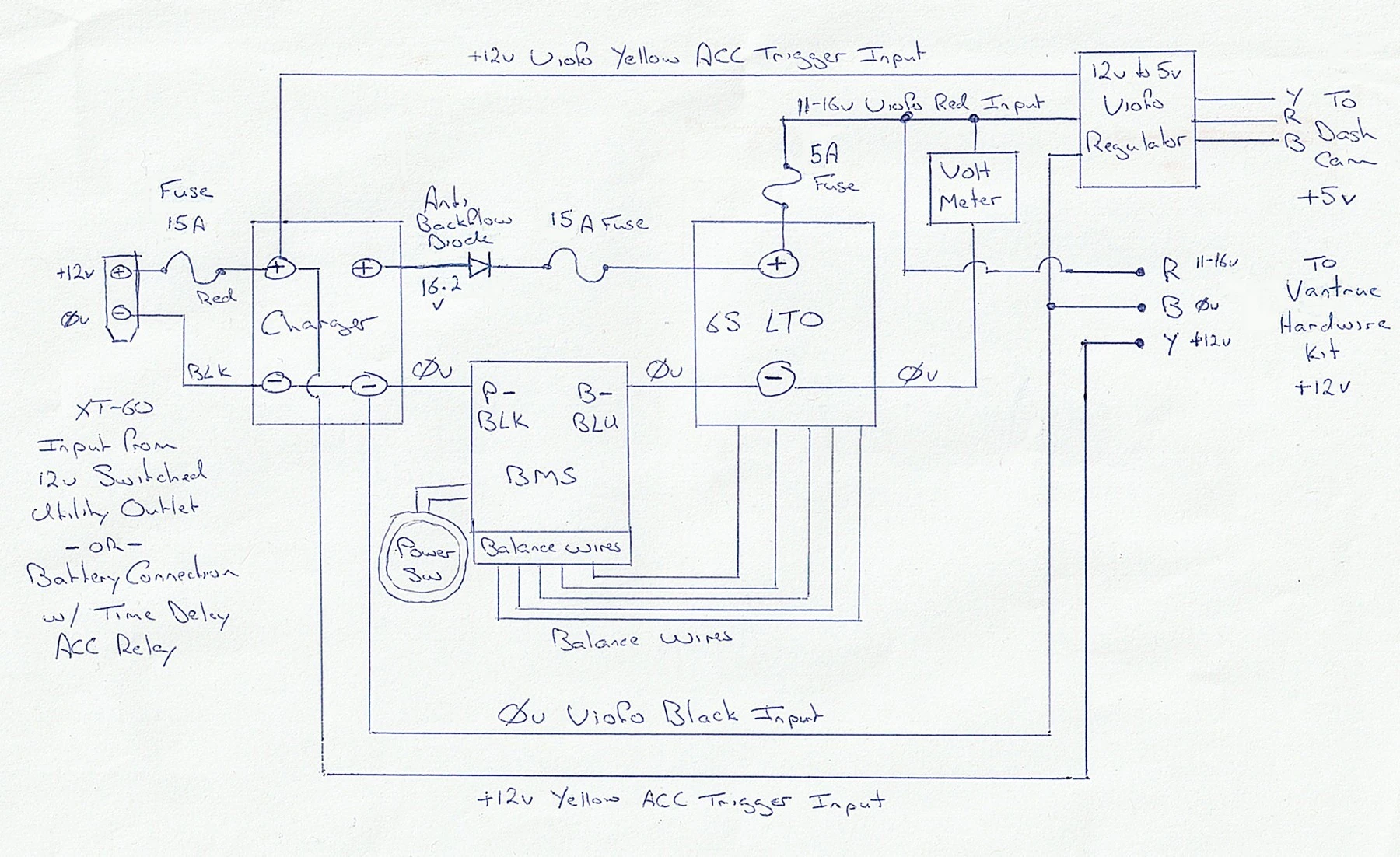

I need to double check the wiring in my LTO box, but I don't think that's the problem. I'll draw up a diagram of my LTO parking battery wiring schematic and post it shortly. The Hardwire kit is connected to my LTO box.
