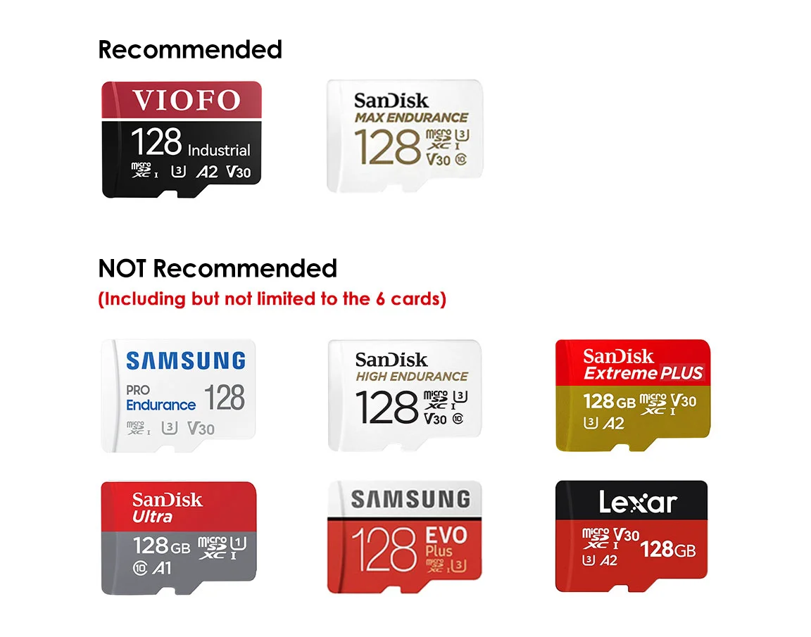

Sandisk High Endurance is not recommended by Viofo.
Viofo dash cams are highly sensitive to the quality of the memory cards. Using memory cards outside of the recommendations can result in slow boot time, slow parking mode activation, skipped frames, and errors just like yours.
Source: What memory card is recommended for a VIOFO dashcam?
Wow , Thanks I thought when I got this card it was the right one, have ordered the viofo , it worked well for a few months oh well.

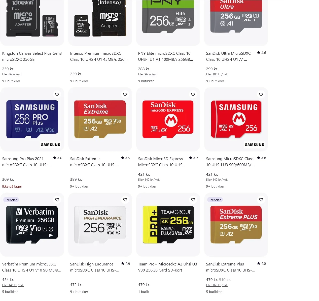

Also with how memory card prices are trending📈. I'd say buy another Viofo memory card before prices go up more. You'll find it useful for troubleshooting, and you'll eventually want to use a new one anyway after a year or so of use with the previous one.
