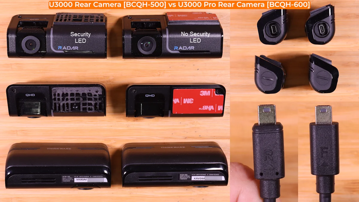

I just investigated this topic for another person. The U3000 Pro rear camera does not have a security LED. The case for the U3000 and U3000 Pro looks similar [white strip where U3000 rear camera has a security LED], but the updated U3000 Pro rear camera does not have a security LED inside of the camera. That's why there is no setting for the rear camera security LED in the U3000 Pro camera settings.
Thanks for looking into this. That's an odd design choice on Thinkware's part, since the U3000 has one. Driven by cost cutting perhaps?
