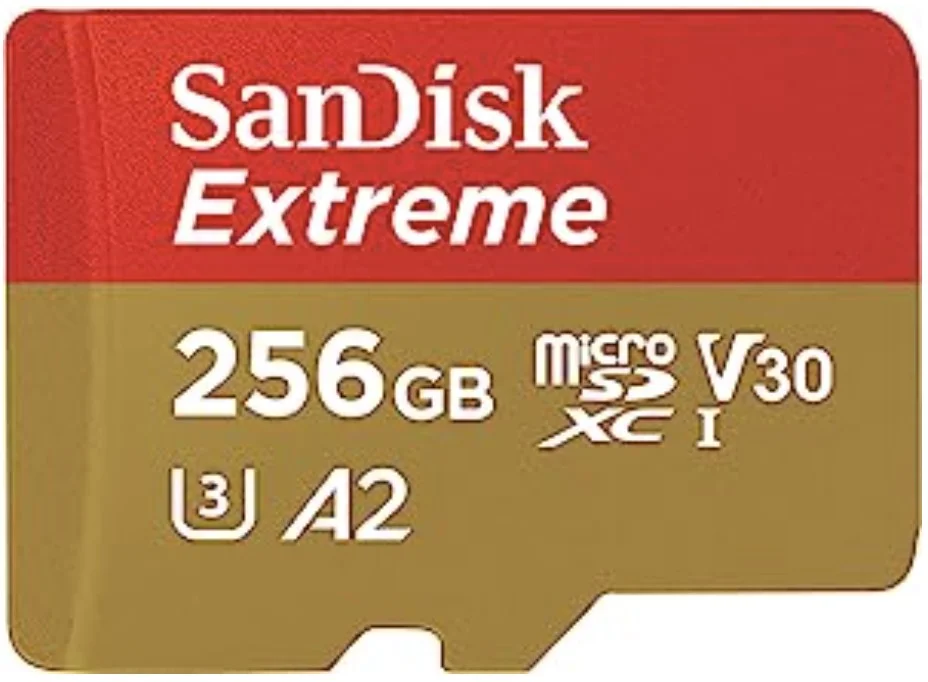

I had my A139 Pro installed by a company that usually installs aftermarket audio systems. They hadn't installed a dash cam in a 2023 Audi S3 before but found two unused (in my car's configuration at least) fuse sockets for driving and parking modes using the Viofo cable kit. I have had no problems in the two months I've had it. I'm using the card pictured below.
They did warn me that if I did experience problems, it could be that they had chosen the wrong fuse socket, as certain circuits in today's cars, depending on the model and its options, are timed to turn on or off after a fixed period by the car's computer after the car itself is turned on of off.
