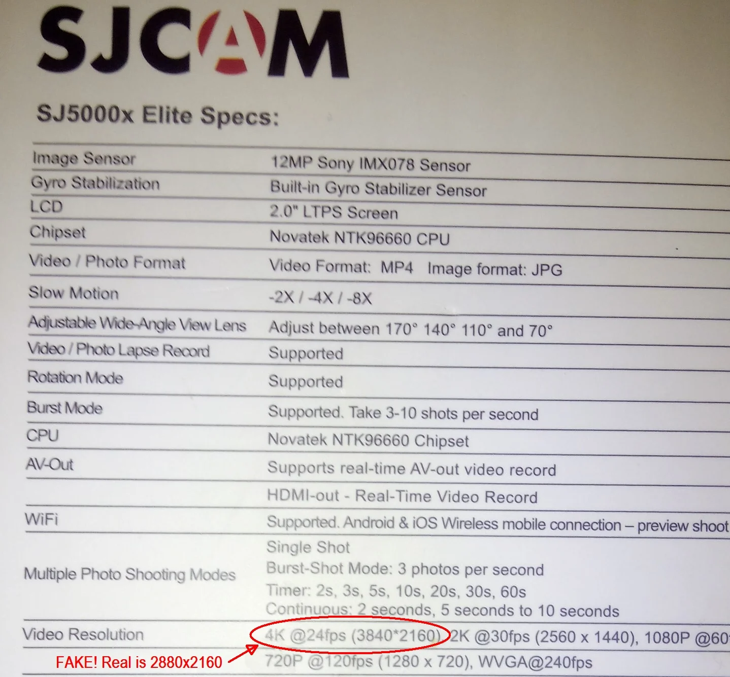

2. Fake 4K resized. The recorded resolution is 2880x2160 which means real 3K, but the camera is advertised as 4K just because the 2880 is interpolated by the player to 3840 resulting in 3840x2160 which match 4K. For example SJCam SJ5000X is advertised in product name titles on all online stores as 4K even on their gift box, but somewhere on a page is wrote that their 4K is interpolated.
Usually these cameras price is over $100 and overall quality can be good, search for people feedback before buy.
A 4K video recorded with SJ5000X analyzed by Mediainfo is showing:
Video
Format : AVC (OK)
Format/Info : Advanced Video Codec (OK)
Codec ID : avc1 (OK)
Width : 2 880 pixels (OK)
Height : 2 160 (OK)
Display aspect ratio : 16:9 (Here is the trick: when a player see the 16:9 aspect ratio it will override the real 4:3 recorded resolution of 2880x2160 and will resize the 2880 to 3840 just to obtain the correct 16:9 aspect ratio)

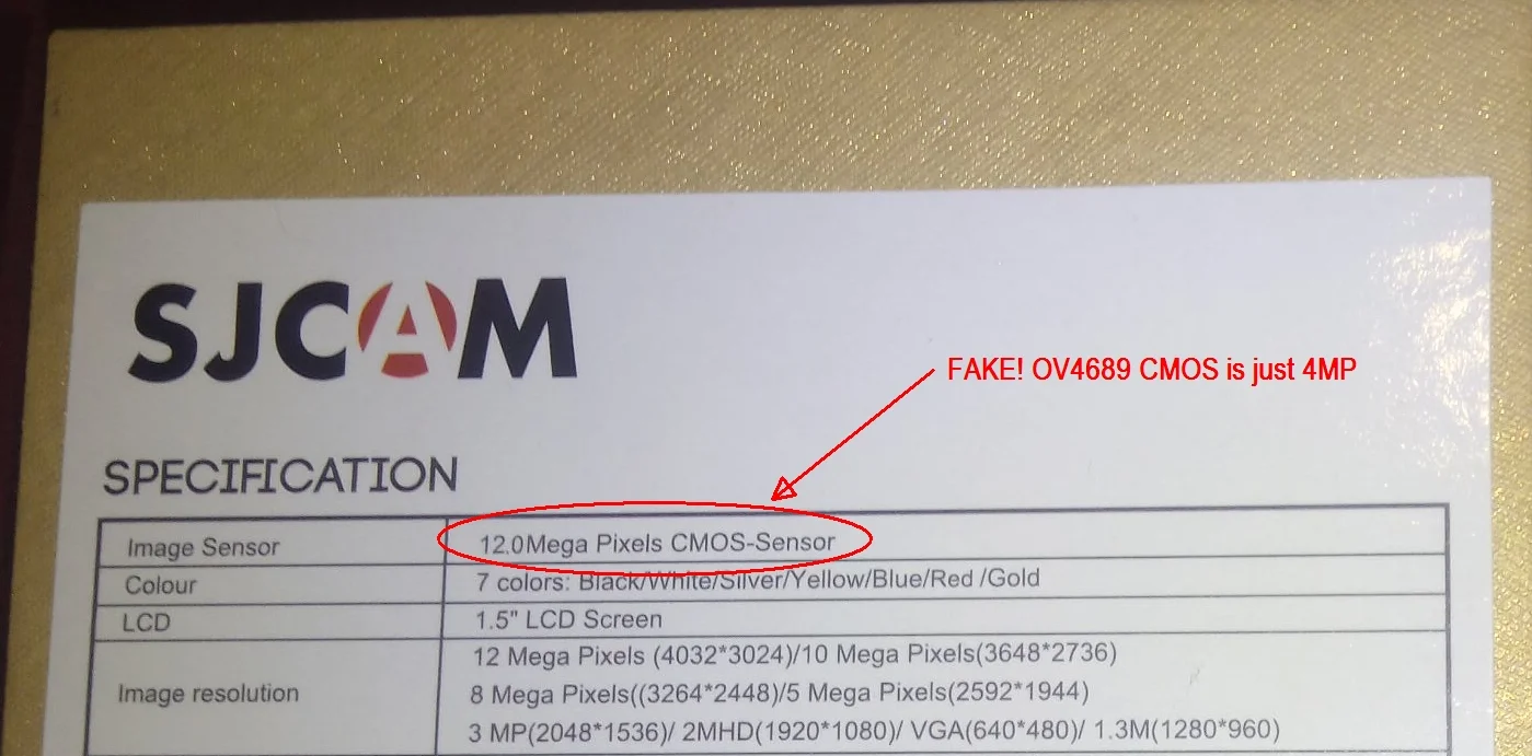

4. Fake CMOS size, this is already an old trick. Here is easy: if for example the camera is taking 12MP photos resized from real 4MP CMOS, the cameras CMOS is advertised as 12MP. For example
SJCam M10+ is advertised as 12MP even the sensor size is 4MP and at least one member of our forum is returning it because of false specifications. Everybody should do the same because now the laws are better for buyers.
