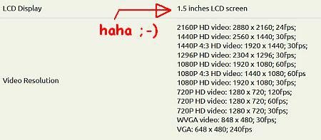

So this is what I have with the Elephone Explorer Pro. The 2K video is 2560 x 1440 @ 30fps. The 4K video is 2880 x 2160 @ 24fps. But it appears a flag is included in the 4K data. Here's how the Properties > Details reads:
Video: MPEG4 Video (H264) 2880x2160 (16:9) 24fps 24513kbps [V: DataHandler [eng] (h264 high L5.1, yuv420p, 2880x2160, 24513 kb/s)]
Audio: AAC 32000Hz mono 96kbps [A: DataHandler [eng] (aac lc, 32000 Hz, mono, 96 kb/s)]
Other camera resolutions and frame rates are as Elephone claims. I've contacted them twice using their online support form, offering two of my different e-mails for reply but they've not responded. They also have a support e-mail address that I'll try because I want to be sure I give them the opportunity to respond. But so far the Elephone Explorer Pro does not appear to be a 4K camera as claimed.

"All" 4K action cams only record 2880x2160 (cheap sensor, weak CPU .. you
cannot get more for $40 etc.) - up to 3840x2160 is pushed by player or
INTERNALLY by camera.
H8R is a "joke" ... 2880x2160/15fps are doubled to 3140x2160/30fps 🙁
I don't believe Sony IMX117 with ELE or other cameras ... this sensor makes up to 4096x2160/60fps

"24,513 kb/s" - that would be a good bitrate for 1080 HD 😉
The Gitup Git2 records 2880x2160 24fps at around 37,000 kb/s. (and doesn't claim to be 4K)
There doesn't exist a video format 2880x2160 - it is always shown as 3840x2160.
2880x2160 is only recording format. 99.9999987% of dealers name this "4K" 🙂

Not true, the Gitup Git2 has two 2160 recording formats, one is displayed at 3840x2160 16:9, the other is displayed at 2880x2160 4:3 and is recorded using the full 4:3 sensor area.
