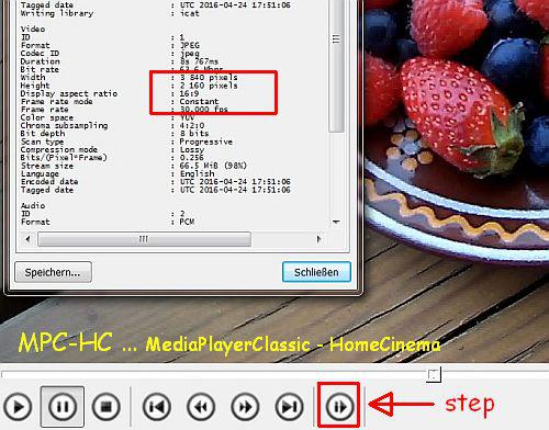

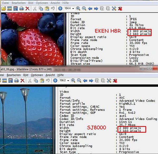

I didn't get this answer ... I wrote also, but got no answer.
I tried diverse players - always the same: 2 following frames are identical!
With all videos, downloaded or own - 30fps is doubled 15fps!
I might have misunderstood. I thought in the screenshot you provided earlier in this thread it showed 30fps, but you said you looked at individual frames to confirm that it's 15fps with frame doubling. I don't know how to do that. If you could explain to me how you did it then I could do the same thing with cameras I'm currently reviewing.
It's easy πŸ™‚ ... play a "4K/30fps" video with MPC-HC and jump from frame to frame.
These videos are very jumping - typical for 15 frames/second
Oh yes, I see! Thanks! πŸ™‚
... and 1080/60fps is only true in bright light. If it is darker, this is reduced to DOUBLED 1080/30fps !
Each "normal" camera doesn't mak such a shi... - even not wit 1/2.3" sensor!
There are 100s of them ... making 1080/60fps, not frame doubling, of course also 4/25fps or 4K/30fps
without dirty tricks. Same for smartphones!
