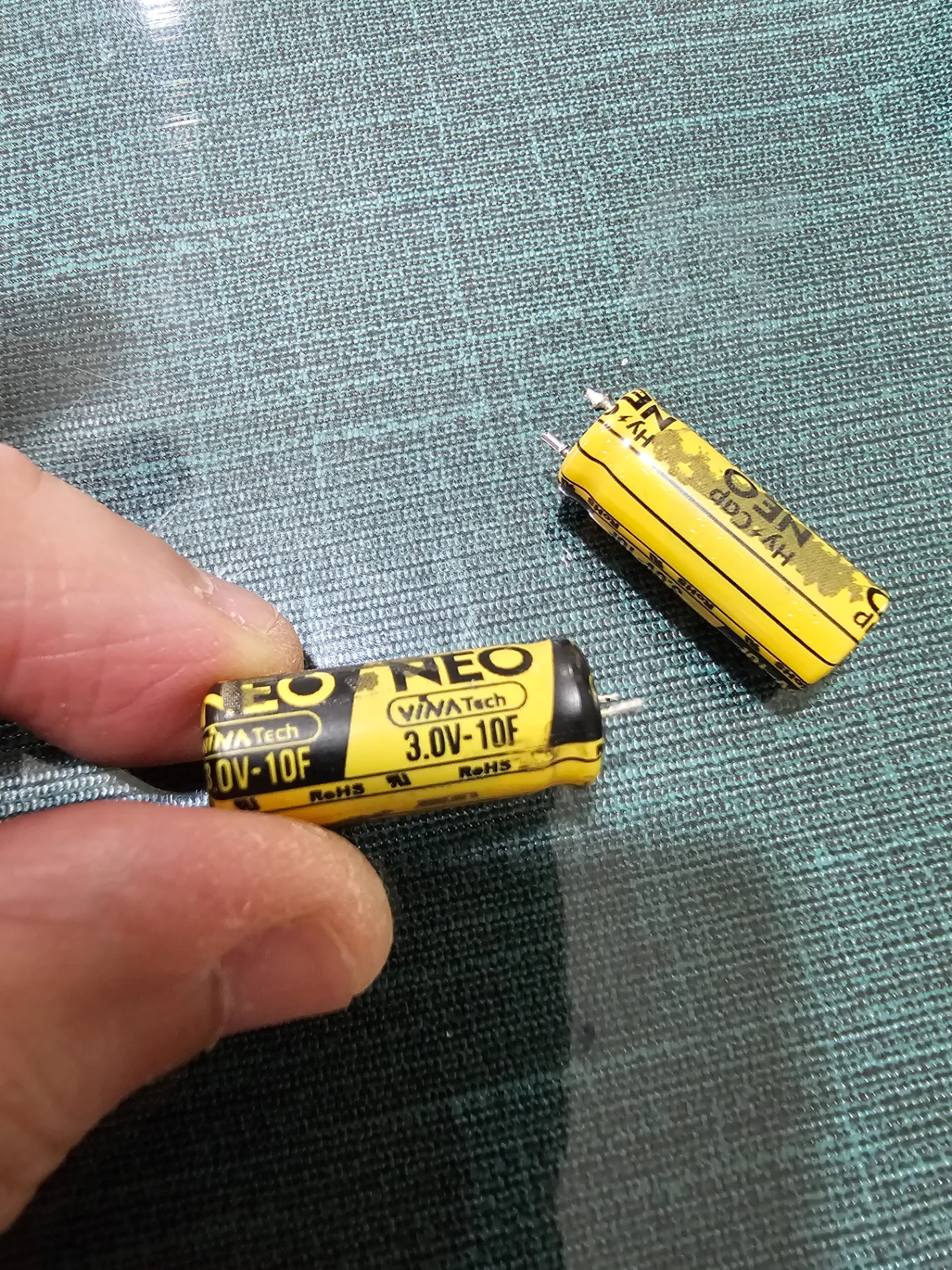

Hi Everyone,
Sorry to dig this thread back but. I just want to let you know that I've same problem with this thread (squeaky/cracking noise after unplug power).
I solve by replace super capacitor in unit has 3V 10F (dimension 10*25) before I replace this I replace backup battery but not solve issue until I replace capacitor.
Now my U1000 work perfectly and no more stupid noise anymore 🙂
Below is my replace cap for your references (purple is new, yelllow is old)
