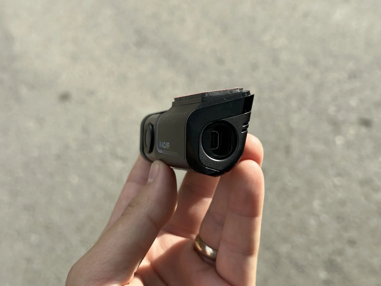

So I've spent the past 4 hours or so testing this out with two U3000's as well as various internal and external mounting locations and at this point I'm more confused than anything.
Generally speaking my rear impact detection stuff wasn't working. I'd walk up to the rear of the car and then literally shove the car, but nothing would be recorded. No motion detection, no impact detection, nothing. (Only the front cam has a G-sensor so whacking the rear window may not trigger the front cam. I tried pushing the whole car multiple times as well as whacking the WS.)
I tried with two different copies of front and rear cams, but it wasn't working.

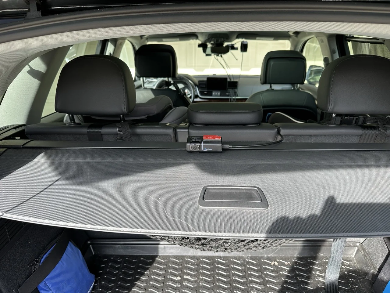

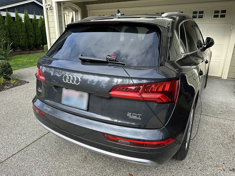

I then tried mounting a rear cam on the outside of my car to see if maybe the rear window was blocking the radar signal. (My vehicle has non-metallic rear tint and so it shouldn't cause any issues. I don't see any issues with my radar detectors either.)
Results were variable. Sometimes it worked, but usually not. I tested with both front and rear cams.
I tried testing with the cam installed in the traditional spot at the inside top of my rear window and it wasn't working. Maybe it is the rear window causing problems, so I tried setting a camera down on the rear trunk cover like this.
This would let me try testing with the rear door open and closed, though the U3000's OBD II adapter thinks my engine is on every time a door is open. Nevertheless, in this situation I was able to get radar motion detection working.

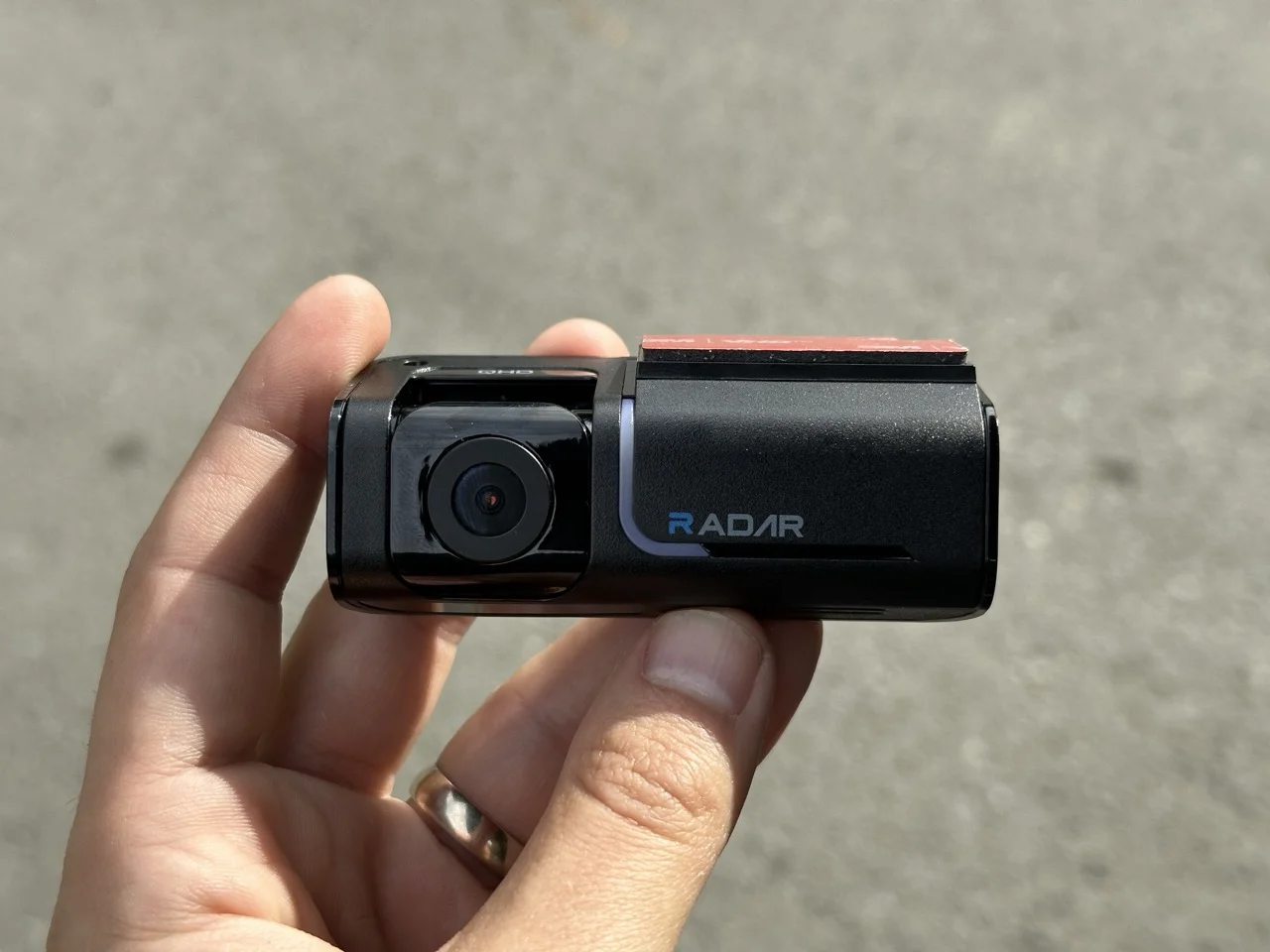

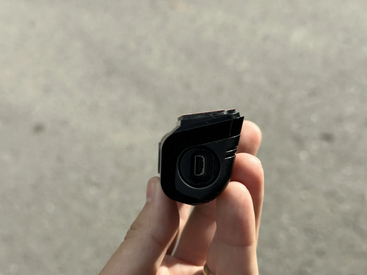

At this point my running theory was the angle of the mount. The mount itself is nearly 90 degrees offset from the face of the rear cam where the radar transmitter is. Unlike the front cam, you can't adjust the angle of the rear radar transmitter.

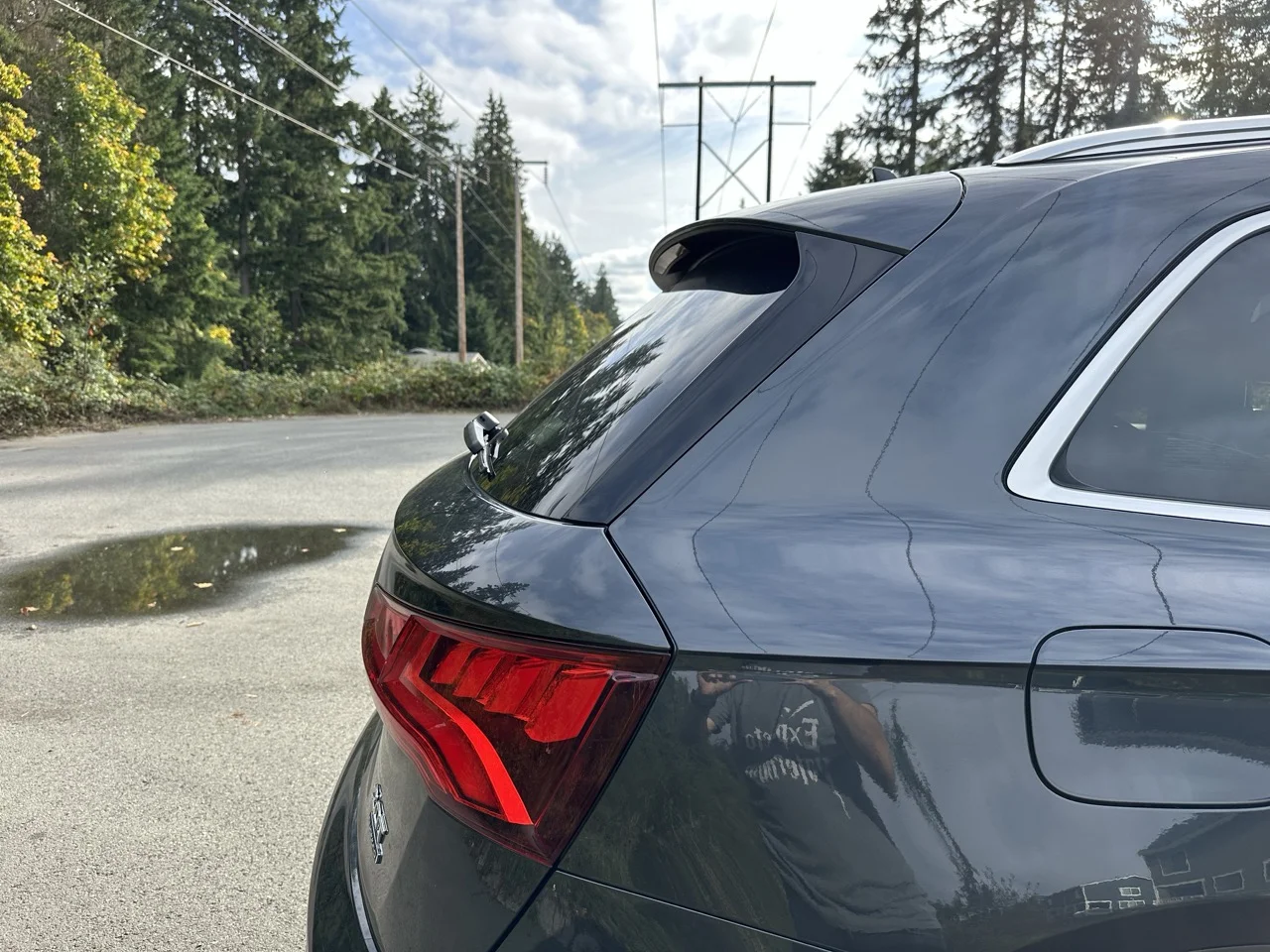

The rear window on my SUV is angled at about 45 degrees.

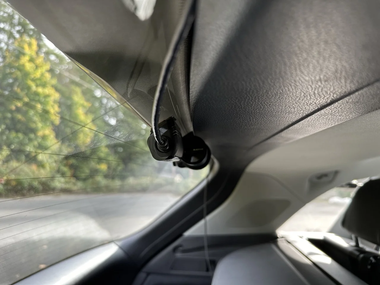

This means that that the rear cam in its traditional mounting point angles down nearly 45 degrees. I have to tilt the lens up to compensate, but you can't also tilt the body with the radar transmitter.
I went out to go retest this, walking up behind the car, as well as trying to get down low to get in line with the radar transmitter. Nevertheless, it recorded the whole thing.
So at this point I'm at a loss and I don't have a good running theory onto why we're seeing what we're seeing. It's great I'm seeing it work right now, but I don't know why the motion detection results are so inconsistent at best, or non-functional at worst.
