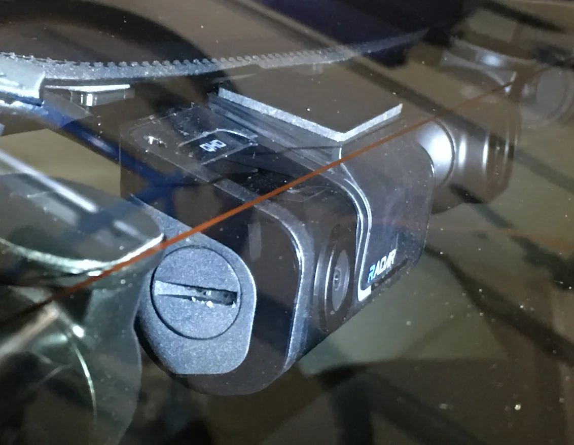

I'm in the UK and my rear camera in parking radar mode doesn't react to movement and record. I own a Hyundai Ioniq 5, I installed my U1000 first and the rear camera LED used to illuminate when I moved in front of it. I replaced the U1000 with the U3000 for the rear radar function but it doesn't work. The retailer I bought it from sent me another rear camera plus cable and front camera, I've tried them all but movement at the rear still isn't sensed and recorded on impact plus the rear camera LED doesn't illuminate when I move in front of the camera. It seems to work OK if I remove the rear window from the equation. If I change parking mode from radar to motion the rear camera LED stays on continuously and movement is recorded through the back window. I don't understand why in radar mode the LED doesn't light when I move in front of the camera behind the rear window surely it should sense the movement and the LED come on even if there's a radar issue. It's as if there's a design issue with the rear camera.

Rear windows tinted like many are these days and I tested the rear camera with the rear window removed from the equation by placing the camera on a rear seat and moving directly in front of it through an open door. Tinting shouldn't affect radar.

I wondered if the rear screen heater elements were an issue but my rear camera is positioned in a large gap at the top. Somebody has posted in this thread that they had to position their rear camera with a heater element in front of the lens and the camera senses fine. It's also been mention that those heat reflective windscreens with a blue shiny coating can cause issues, my rear window doesn't look like that, it looks like a normal tint. I don't understand what's going on especially as my U1000 rear camera senses movement through the same rear window fine.
I don't know how you know that it wasn't the front radar that was detecting you, in fact I think it was very likely. If you could extend the cable out the back of the hatch and more or less close the hatch with the camera/radar outside the rear window then that would be a much better test.

It wasn't the front radar as I was behind and the radar projects in front of the camera. Thinkware told me that this issue is only in the USA and Canada due to differences in the law concerning radar, I'm beginning to think that's not true.
Normally, these radar modules can see 360°, but can see much further in the forwards direction. There is also the possibility of the radar beam bouncing back into the car, maybe off another vehicle, or maybe just off your own A-pillars. Either way, there is a likelihood of the front radar seeing people in the front seats, and I wouldn't rule out it seeing people in the rear seats.

As far as the rear heating strips, they're super thin so I'd be a little surprised to see it make a huge issue, but to be fair the rear cam's radar module is right up against the rear window (not up on the front window like a radar detector) and so if the alignment is just right, perhaps one of the lines runs right through the radar transmitter or receiver so it could be possible.
Certain higher end luxury vehicles to have heated windshields (which I believe also have teeny metallic strips running through them) or different types of acoustically insulated glass that could cause issues for radio waves. If this is the case, there's usually 1-2 cutouts on the window, perhaps near the RVM or the bottom center of the window, where you can place a toll pass, GPS receiver, or phone. These are areas with little cutouts designed to let radio waves pass through unimpeded. I don't think I've ever seen similar cutouts for rear windows since people don't stick toll passes or phones back there.
The heater lines on the rear windows are far too far apart to block radar frequencies, and the transmitter antennas are significantly bigger than the lines, so even if placed directly behind a line, it will not make a big difference.
The front heaters have much thinner and more closely spaced lines, I think they are still too far apart to be a big problem, but they also tend to be wavy so maybe they can cause problems, but it is not the front that people are having issues with!
These radar waves are 10x smaller than microwave oven waves, they would easily escape through the grill in a microwave oven door window!
