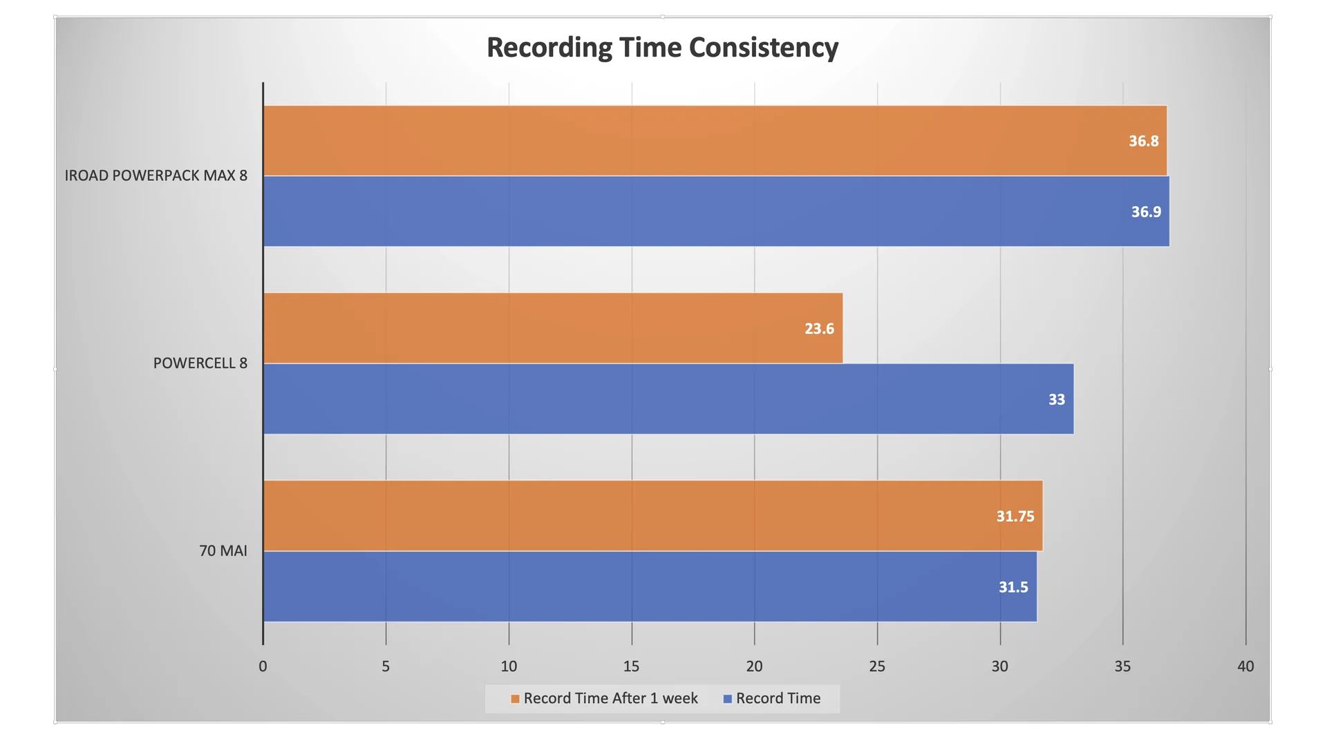

So we wanted to test how 1 week after the battery pack was sitting on the bench how it would work.
1. Is it consistent?
2. Is it losing charge just sitting there with no load on the battery pack?
Here are some notes
Powerpack Max 8 - Installed in my vehicle for 3-4 weeks now via cigarette lighter plugin charging Has had multiple charges
70Mai has been charged approx 10 times on the bench throughout testing
POWERCELL 8 - We got this from a customer 1.5 years ago. We gave the customer an IVOLT XTRA in exchange for this powercell8. It is approx 2 years old. Please note: It did not sit in our office collecting dust. We used it in my own vehicle for testing and comparison for last year compared to other battery packs we carry. So it has been consistently used for the last year. Not sure if this is normal expectations of this battery pack or something is wrong with performance of unit as the drop off is approx 29% when sitting for 1 week.
I don't see the on/off button on the Powercell 8.
Is Bluetooth always on? Or the USB-A port?
