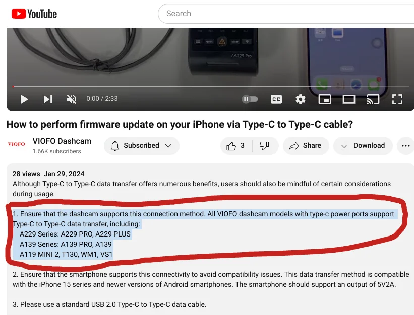

Based on transferring files between the camera and the smartphone via a type-c to type-c data cable, you can also update the firmware through your phone in this simple way.
We have uploaded a video showing how to update the firmware through the iPhone you can refer to:
If you are interested in the process of how to perform firmware update on your Android phones, you can also download the video from this link:

Please write which Viofo models support this function.
All our models with type-c ports.
