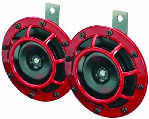

Next tried the Hella Supertone. These had screechy tone but acceptable volume. (500 & 300 Hz frequency)

After reading a hobby magazine on industrial horn & whistle, I decided the screech effect could be mellowed with the 400 Hz horn, and using both sets would boot the total volume effect. It did work very well. The horn booms (for an electric) and the tone is better than either set on their own.
Obviously this draws more current, so check that your car has a good relay. My 30 amp relay works just fine. Also these horns come with a simple flat bracket so look at your current horn mount and near area to check where you would mount the horn. I had to remove my grill to work on the horn mounts.
