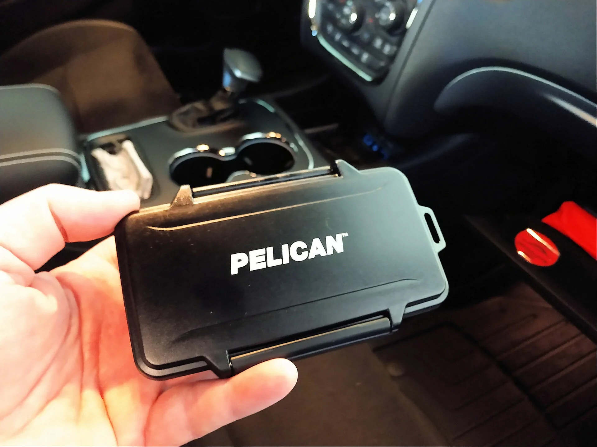

At the risk of pigpiling a bit, you definitely want to carry extra SD cards, already formatted and ready to use, as well as check your footage from time to time to make sure that the cam is working so that you can be confident that your video will be there when you need it. Not trying to poke you in the eye, but that's pretty much dashcam 101. I carry several in a case designed for that specific purpose in the car all the time:

To say that you should carry around a peli case full of SD cards is just flabbergasting, for non-professional drivers who just want to catch the moment they're cut off, or someone is speeding and want to send it to the police later, this is just silly.
