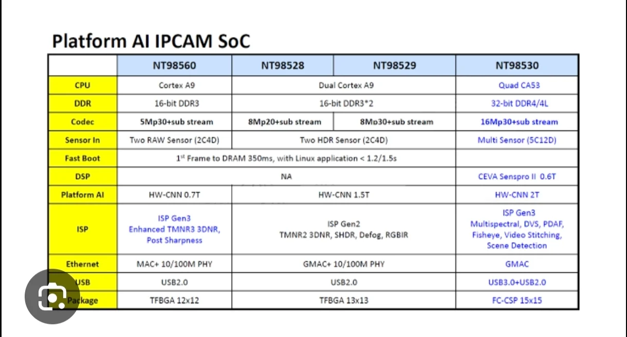

Which when you Google it, then that becomes very similar to NT98528/NT98529 etc etc
Yeah, same as Novatek NT96580, not sure why they call it by a different model number when they are the exact same chipset

There is no NT96680. The NT96580 is also called as NT98528, the advanced version is NT98529.

There is another possibility that they confused the numbers in the NT96580 as being NT98560.

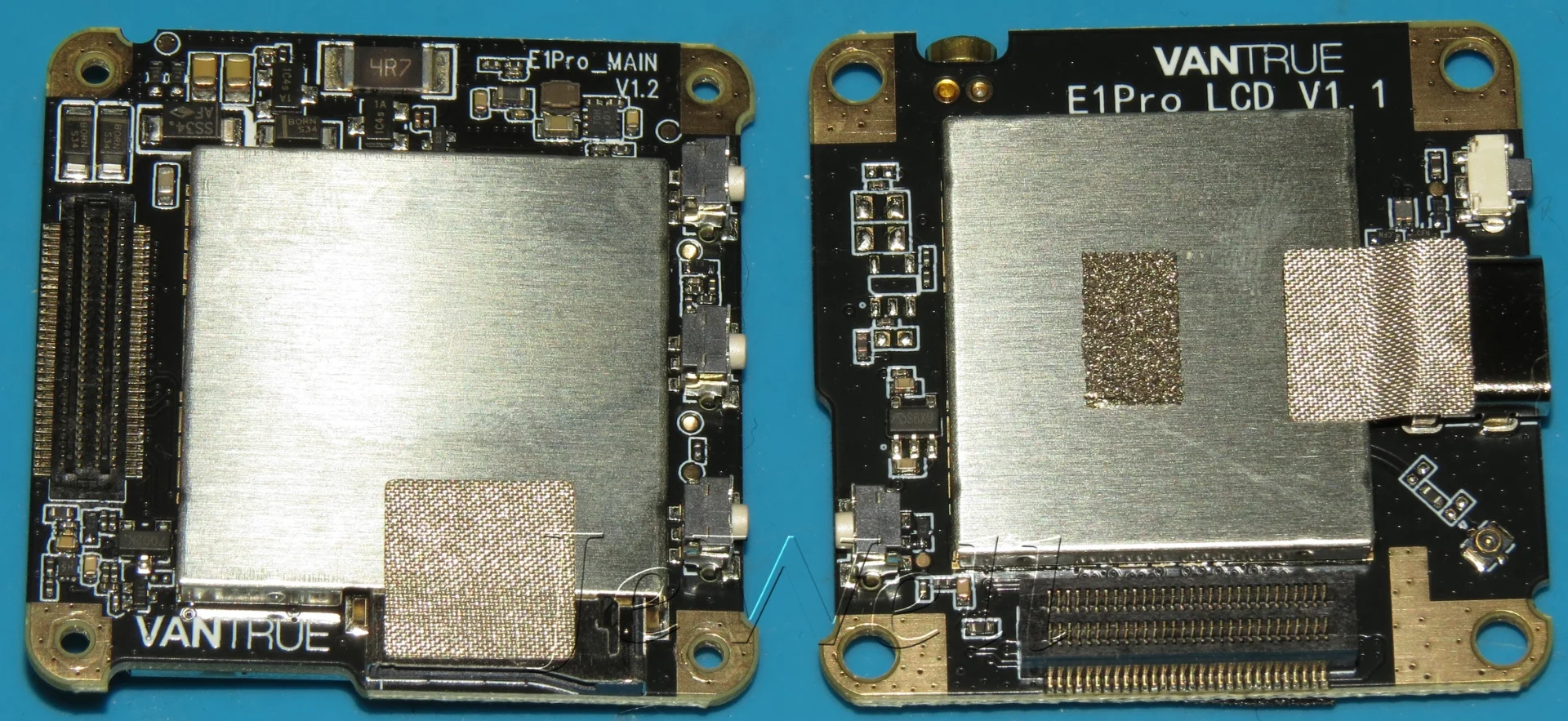

Photos of the disassembly process.
In theory, it was possible not to unscrew the screws that secure the connection connector. But I did not know how to disassemble this device, so I started with them.
The main idea is that the case is assembled on both sides: where the lens is, there are just latches, and where the screen is, there is double-sided tape, under which there are screws. To unstick the screen, you need to warm it up a little (with a hot gun at 150-160 degrees Celsius) and lift it with a sharp blade.
Then everything is unscrewed. The boards are assembled in a "sandwich", one above the other and connected via a connector.

Although the processor does not heat up that much, the radiator, to which the heat from the processor should be dissipated, could dissipate this heat much better if the heat sink was implemented correctly. Now the heat is removed through thermal paste to the shielding metal plate, and from the plate through the pink heat-conducting "chewing gum" to the radiator. Moreover, the radiator does not fit tightly to the shielding plate because the metallized tape is in the way, and there is very little of this pink substance there.

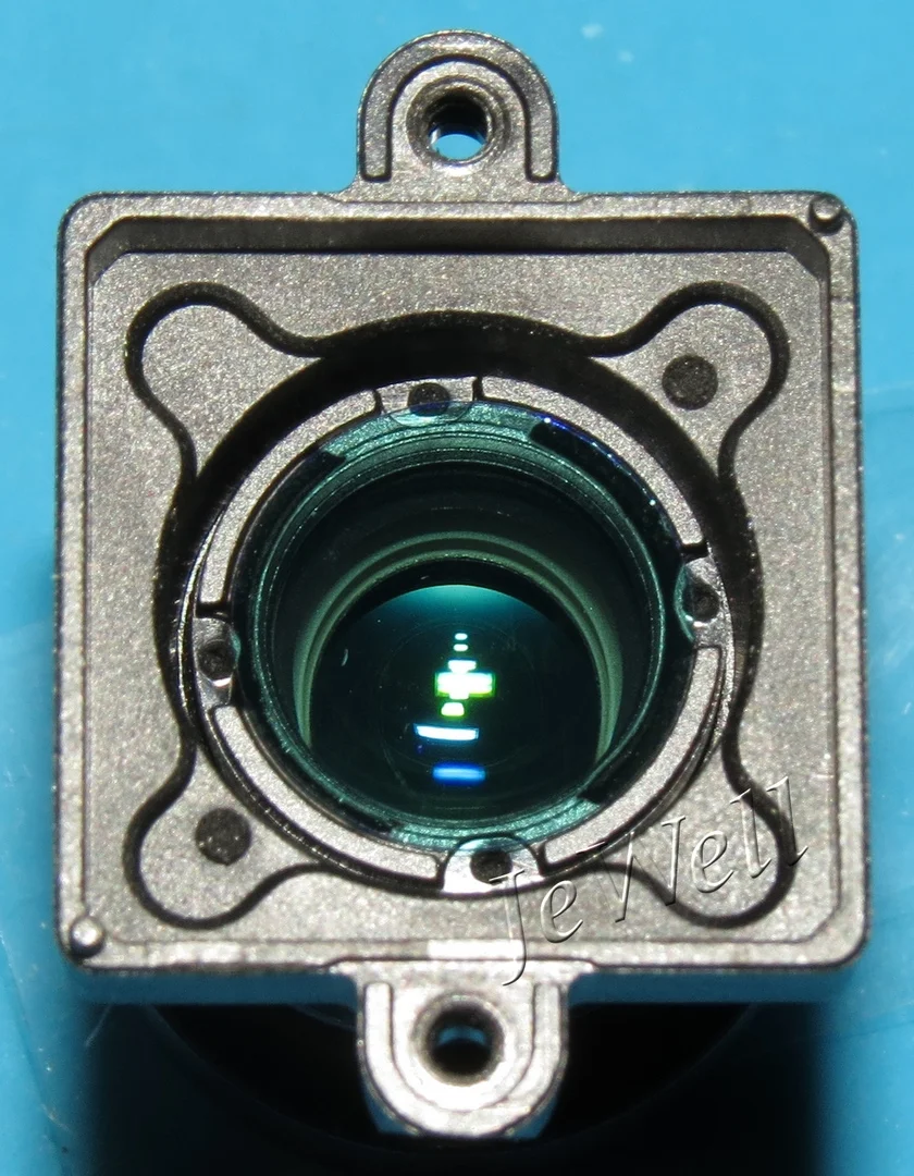

The lens holder and the lens itself are plastic.
The heat from the video sensor is not removed anywhere at all, except to its board. The 70mai a810 device has the same video sensor, and there is a radiator there to remove heat from the video sensor.
