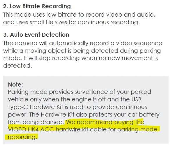

The A220 Pro manual V26.01.09 has two contradictory things to say about this. See attached images.
Page 28, image below, recommends an HK4.

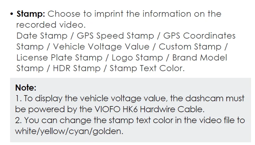

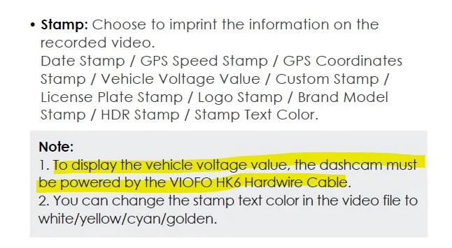

Page 38, second image below, says you need an HK6 to display vehicle voltage.

Page 28 "recommends" HK4.
Page 38 mentions HK6, image:
