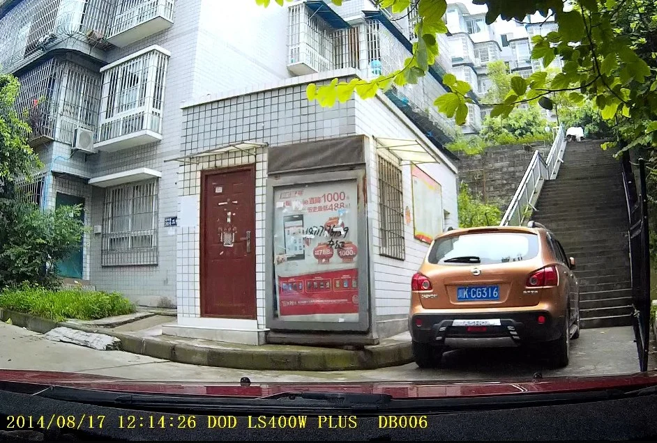

Hi jokiin, i am glad that you are currently being online, so may i ask: How come my brand new dod ls400w plus has a very annoying issue that when temperature is little high that it loses focus??? So after i buy i had to returned to the seller and got another new one, but it is same! Now when i am writting in here my ls400w plus has been sent to shenzhen official factory to test it out, and been a week+ already, their support told me this afternoon that they have done 75c degrees testing and found the pictures are blurred, now they are doing 45c degrees testing again. I am very disappointed because i do not think they will fix it anyway, but would you suggest me a mode of DOD that it may have better heat-defending so that i can question them to replace it for me please? because i have asked them to fix it to me and while they are doing the test they have forwarded my message to their Superiors. Thank you.
I forgot to mention, when i said the 'temperature is little high' which means even it is 23c degrees indoor that outdoor is cloudy this kind of weathr in this fall this camero goes to losing focus by only parking the car outside for only 3 hours! 🙁
PIC 1: Normal. PIC2: Losing focus baddly!
buy something else, the lens is not good quality, it will lose focus as it warms up, once summer comes it will only get worse

You must disassemble lens from mount and setting focus again. Mount is firmly glued, then You must cut a bit of mount. Then plugin DVR to TV and setting focus. The focus must be set to the middle of the focus range. Glue on thread and mount and done.
