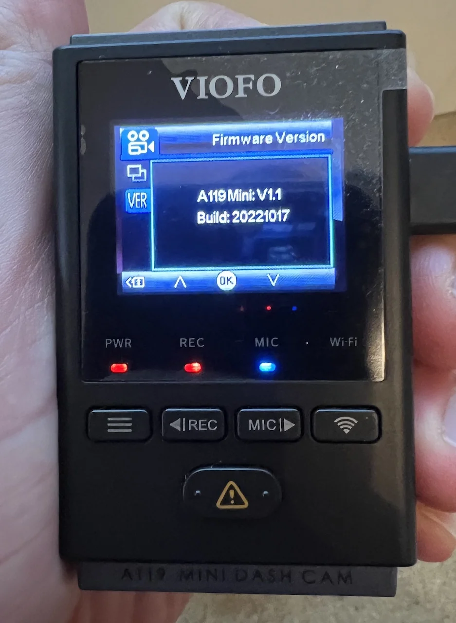

Another person flashed his Mini with the same file that I flashed my copy and it shows: v1.1_20221017
Something is wrong with my model.
Tomorrow I will install on it first version V1.0.20220519 and then version V1.1_20221017.
I think this will help.
  • Like
Reactions: gse
I flashed my model with new firmware: V1.1_20221017
The problem was in the 2GB memory card which I flashed all my models.
I downloaded the same firmware file: V1.1_20221017 on two memory cards 2GB and 64GB.
I inserted a 2GB memory card into the DVR and turned it on. The DVR flashed and turned on. All settings in the menu were factory, but the firmware version in the menu was: V1.1_20220919.
Then I inserted a 64GB memory card into the DVR and turned it on. The DVR flashed and turned on. All settings in the menu were factory and the firmware version in the menu was: V1.1_20221017
