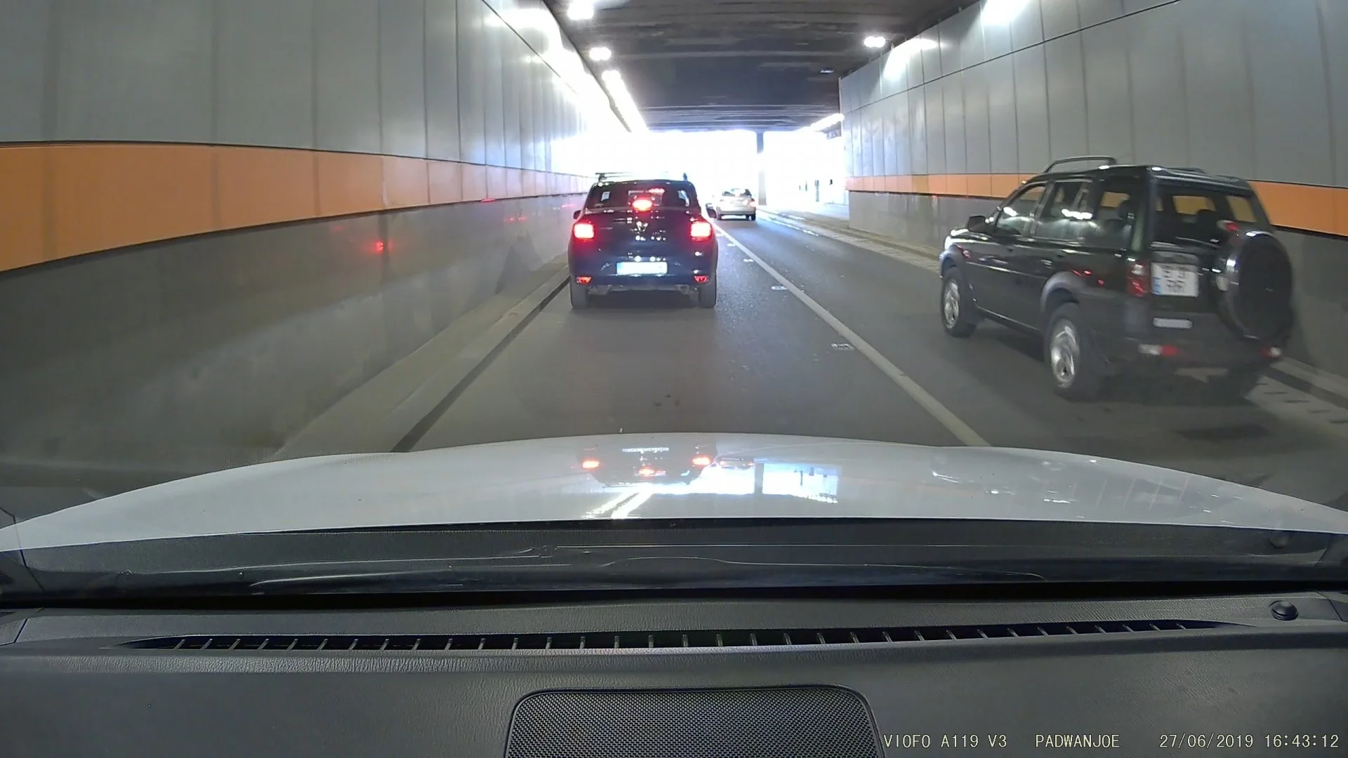

But let's move to video samples. For today, I will show you how the A119 V3 behaves when driving through an underpass with and without WDR.
The first video is recorded at 1440p, High Video Bit rate, WDR On and at slow speed because of the traffic conditions:

The second video is recorded at 1440p, High Video Bit rate, WDR Off and at high speed because of the traffic conditions:

What I can say for now is that the A119V3 started to record every time I started the car engine, that it properly saved the last file after the shut down of the engine (I checked it on my PC)) and that it endured high temperatures (37 C / 98.6 F) left in a closed car without any problems so far.
I also have to mention that the audio recording is still at a low level (to low for me) and my unit did not like to work using a 64 GB Kingston U1 Class although I formatted it in the camera and after that on a PC (the same card was previously used in a Viofo WR-1 with any hiccups.
