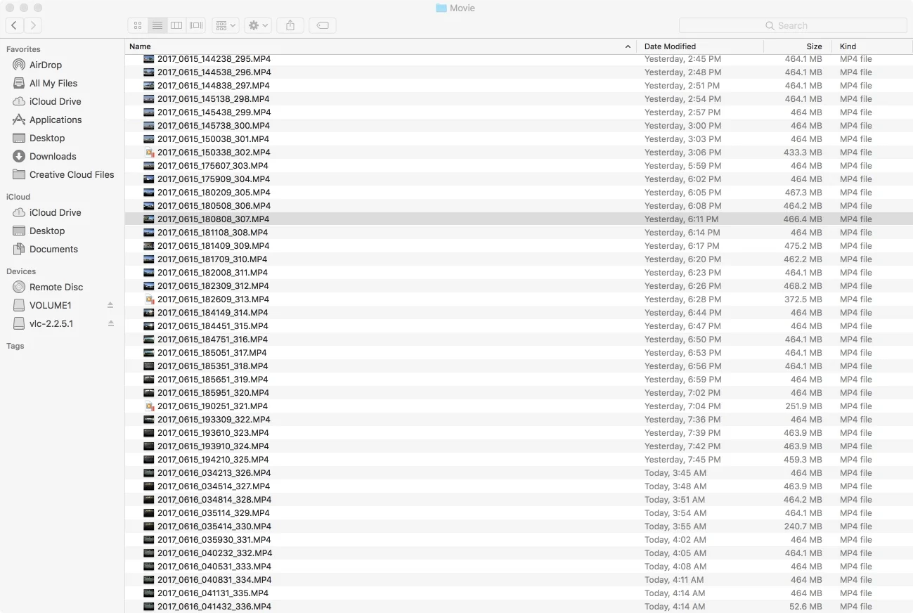

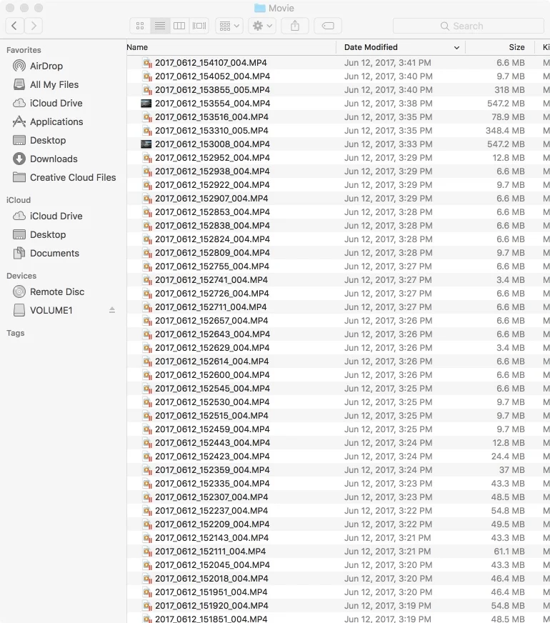

Against my better judgment, I did not return the last 2 VIOFO cameras I purchased given issues I had recently. My wife had a parking lot accident today where a car backed into her. This is what the SD card has on it. Pissed off... Looks like it stopped working 3 day ago. 3 Cameras now have garbled files or frozen up with premium high endurance 64GB video cards. I thought the firmware update about a month ago was to fix these issues?

Looks rather hosed. Lots of 10-15 second files. Yuck.
have you been formatting the cards in the camera after using in your Mac?
Yes. The first thing I do when I put a card into a camera is format them in-camera. Getting real frustrating. Now I feel like I have to check the memory cards daily on my Viofo cameras.
