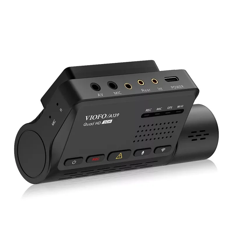

I have recently purchased the A139 and got around to installing it in my car today.
It shipped with v1.2_0507 firmware. It records perfectly fine with just the main camera and/or rear camera attached.
However, when I connect the interior camera, it just keeps saying "recording 3 channel started" every three minutes or so.
I have tested the camera using a Samsung EVO Select 256gb memory card and a Blackboxmycar branded 32gb memory card.
The Samsung is formatted as exFAT and the BBMC as FAT32.
Both these cards were recognized by the camera and recorded properly.. until connecting the interior camera.
I thought it may be a firmware issue and downloaded and installed the newest firmware.
v1.5 was installed with no problem and the camera again recorded with the cards perfectly.. until connecting the interior camera.
I have connected to the cameras using wifi and I am able to see all three cameras, but for whatever reason, it's not playing well recording with the interior camera.
I am at a complete loss and am unable to find articles of similar problems in google searches.
Has this happened to anyone here?

So as it stands right now:
Primary cam alone works
Primary cam + rear cam works
Primary cam + interior cam works
Primary cam + rear + interior does not work
I have a video of the problem with the unit

I tried the two cord individually and they appear to work when only one additional channel is added (2CH)
It's only when it's 3CH is where the boot loop issue begins.
I have used the SDFormatter tool on both cards and both cards record properly in 1CH and 2CH.
They are unable to record in 3CH as the unit keeps boot looping.
I own both a Cellink Battery B and BBMC BI-750 both with 12v outputs.
I tried them both and was met with the same problem.

I'd vote faulty camera...You need to RMA the unit for replacement.....See what other's say.
Yeah you probably need to contact seller ASAP and get things moving in regard to a solution or a replacement or a refund.
Something do seem to be fishy here.
I am not sure if anyone have added that particular samsung card to my what cards work with the A139 thread.
But it might well be okay, the A139 dont seem to be card fussy, it have eaten every reasonable card i have put in it.
Were they both checked still using the supplied Viofo 12V power lead though? Bit difficult to check if you haven’t another one though but at the same time im sure you don’t want to wait for one to arrive from China only to find it’s the same.
Not used a 256GB version but Sansung EVO Select 32GB, 64GB, and 128GB sizes all work flawlessly for me.
It does seem the problem is either the cam or insufficient power.
Did you try the Viofo 12v adapter plugged directly into your car's 12v socket?
Did you format the card in-camera?
Yes, the only power source used was the supplied in-box cigar/usb-c adapter
This was used with the cars 12v socket as well as the two battery packs for testing
Yes, supplied adapter was tested in the cars 12v socket as well as two battery packs.
The card was originally formatted using the SDFormatter tool, once inserted, the camera picked it up no problem.
I did attempt to format it with the camera once, failed, I then did it again right after, successful.
I have reached out to the seller and they are working with me to resolve the problem.
