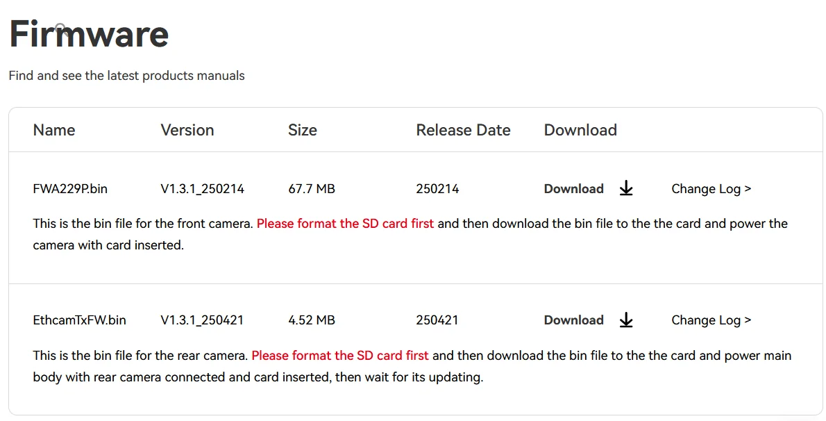

I think if you were to contact Viofo they would tell you to format your SD card and update the firmware.
There is relatively new/updated firmware for the rear cam, possible the main cam too.
Link to Viofo firmware: https://www.viofo.com/pages/firmware

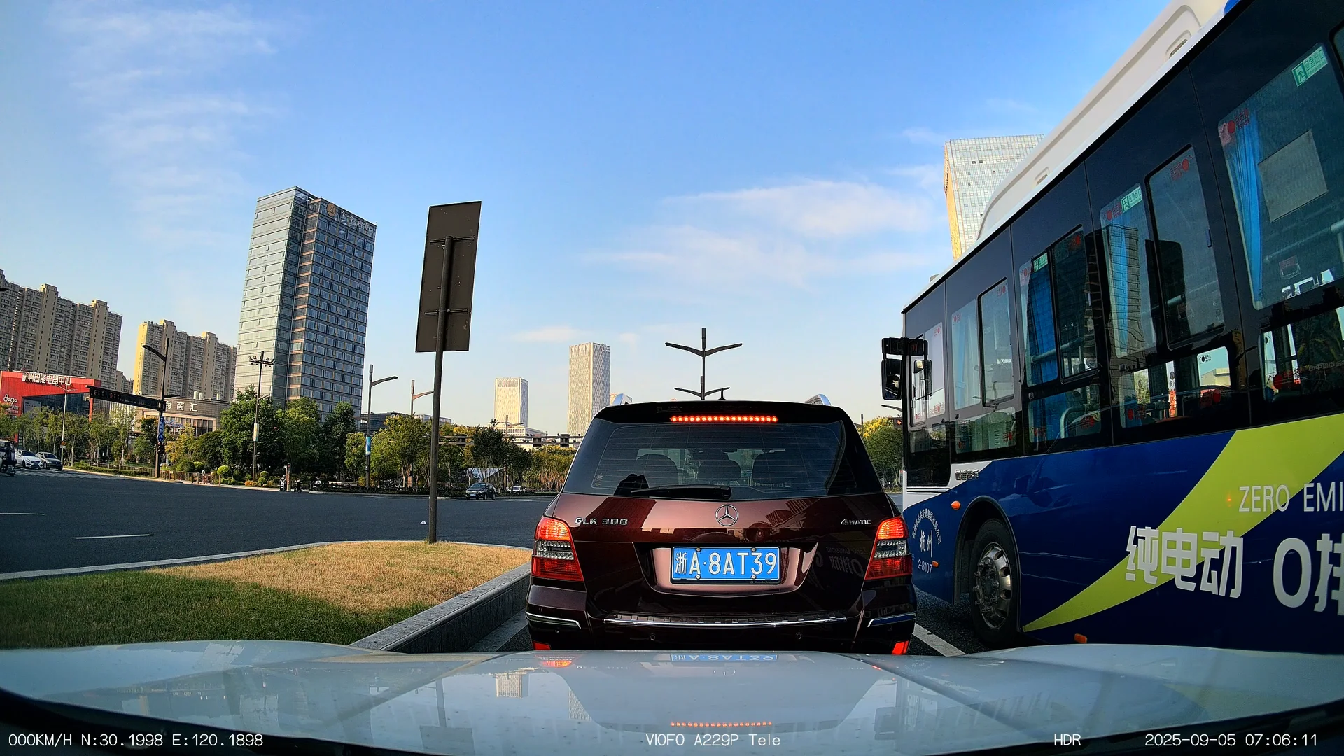

Hi guys, this pro tele version firmware brings brand new color style for the main channel, it is recommended that you upgrade.

Could this be the effect of HDR being turned on during the day?
Personally, I don't turn it on during the day, although I should try.

Nothing will happend, the main camera and the additional lens have their own firmware, and they will not affect each other.I think this tele version is just different in color from the previous version, the pro tele version brings better color style.
