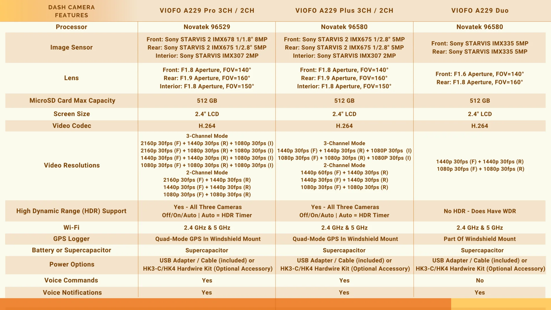

Feature Comparison Chart - A229 Pro / A229 Plus / A229 Duo

A229Duo can't record at 2160 resolution - only 1440(F) + 1440(R) or 1080(F)+1080(R). Please fix it.
Thanks for catching that. I also corrected the A229 Plus 2CH resolutions. The VIOFO website shows a 1440p 60fps (F) + 1440p 30fps (R) resolution option. Now that I have the A229 Plus in my hands, I checked the "Resolution" options in 2-channel mode (F + R) and there is no such option. I'm sending an email to VIOFO to correct either the firmware or the website depending on which one is incorrect.
The 60fps option is present. I had the HDR feature enabled which restricted the list of resolutions listed in the firmware screen.
